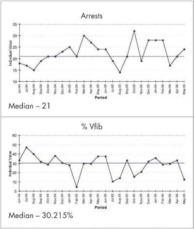

Let's test out these conclusions. I was handed this report to use as an example in a seminar and intuited that "total arrests responded to" is an important organizational number. It's also clear that the proportion of these arrests in "Vfib" is important. In the latter case, I had to create it (for example, 6/94 is six out of 18, or 33.33%). Sorry to horrify p-chart purists again, but I then "plotted the dots" to produce two run charts as shown above.
As you see in both cases, there's neither a "trend of seven" nor any "run of eight consecutive points either all above or below the median." So, the conclusion is that nothing has changed in two years--which everyone in the room would have concluded in about 15 seconds had the data been presented in this way and had they known the simple statistical theory of run charts. Moreover, it could have saved precious meeting minutes of empty discussion and hours of subsequent searches as people looked for explanations--and found them.
As espoused in previous columns and once again demonstrated, never underestimate the power of looking at a situation as a "process" and "plotting the dots"--even in administrative situations different from your day job.
