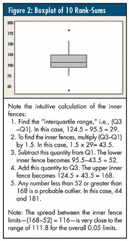

A five-number summary can be constructed from the table in figure 1, where the minimum is 42, the first quartile (Q1) is 95.5, the median is 107, the third quartile (Q3) is 124 and the maximum is 181.
A box-and-whisker plot (as seen in figure 2) is a distribution-free graphic that takes the five-number summary one step further to calculate a criterion to detect potential outliers.
The first and third quartiles form a "box" containing the middle 50 percent of the data. With the median notated within the box, lines are drawn from the sides of the box to the last actual data values within the inner fence (described below), i.e., the "whiskers." Actual data values outside of this fence are plotted with an asterisk.
Note: The standard deviation of all 21 scores is 29.2, which, to correspond to the inner fences, encompasses approximately ±2 standard deviations around the mean. Of course, this is a moot point because the presence of special causes invalidates this (typical) calculation--and once again demonstrates that three standard deviations, calculated correctly, is a very good criterion for declaring outliers.
