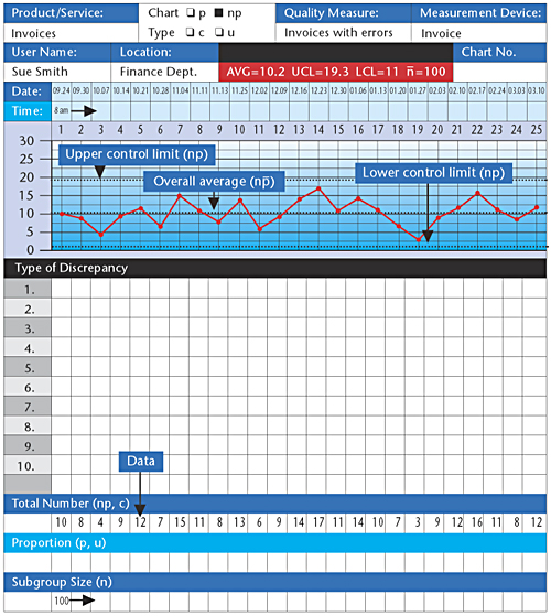

                      the number of deliveries with mistakes.   He develops the chart below, based on the data provided
                      by the pharmacists.
  However, when Sedrate analyzes the chart, he's disappointed
                      that the system seems to be in control. "I was hoping
                      to see lots of out-of-control points so we could eliminate
                      special causes," he mutters to himself, deciding that
                      the np chart gives him nothing dramatic with which to enhance
                      his portfolio in the hospital. He's so worried that he finds
                      himself losing sleep at night. Is his anxiety merited?     Sedrate's high blood pressure is pointless because the
                      pharmacy process gives him plenty of opportunities to improve
                      quality. The point is not just to identify out-of-control
                      conditions but to improve the process. The np chart reflects
                      that the process is now generating an average of 10.2 nonconformities
                      per week.   By brainstorming and using cause-and-effect analysis,
                      Pareto diagrams and other problem-solving and data-analysis
                      tools, Sedrate's improvement team can identify ways to further
                      reduce the number of missed prescriptions.
    Quality improvement isn't simply gathering data but analyzing
                      data and organizing it in order to determineways to improve
                      a process. The plan-do-study-act cycle focuses on continuously
                      examining processes in order to bring them to even greater
                      levels of predictability.     Michael J. Cleary, Ph.D., is a professor emeritus at Wright
