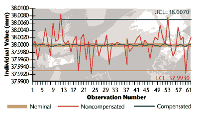

 Would it shake your confidence if you learned that, even with a 10-percent gage R&R, gage accuracy can drift over time by as much as 50 percent to 100 percent of tolerance without you being aware of it? If a gage appeared to give accurate readings but was actually off by a large factor, what would it be doing to your process? Your process could be out of control and you wouldn't know it. It would be like being on a diet and thinking you were shedding several pounds a month only to find that the scales were wrong and you were, in fact, gaining weight. That's the kind of effect that temperature changes can have on shop floor gages--gages that are performing a vital function. Don't be fooled by the myth of short-term gage R&R. Gages that operate on the shop floor, even in supposedly controlled environments, are more often than not subject to temperature-induced drift. It's usually just too subtle an effect to be obvious, so it's often overlooked or ignored.
 However, you can easily test this for yourself. Measure the same feature on a workpiece repeatedly, using the same gage, over a period of a few weeks. Write each measurement down. If you have a thermometer, you might also want to write down the ambient temperature at the time of each measurement. After you have taken several measurements, compare them. You will probably see variation, and this variation will most likely correlate with recorded temperature variations. (Of course, there may also be thermal influences other than ambient variations that would account for these differences. Machining operations, coolants, washers and other factors may be causing temperature changes as well.)
 Figure 1 shows an example of such a study. During a two-week period at a major automobile engine plant, the same crank pin on the same crankshaft was measured about 60 times using the same shop floor gage. As the graph illustrates, measurements varied by 16 microns on a part with control limits 14 microns apart--more than 100-percent variation. However, the gage used for this test had been certified to have a gage R&R of better than 10 percent. Temperature accounted for 90 percent of the variation seen in Figure 1.

 The dramatic improvement obtained by using automatic temperature compensation is shown in the results of the third run in Figure 3. In the final long-term run, temperatures were again allowed to rise by 5°C (9°F) while the same 100 parts were being measured, but in this case, temperature compensation was applied. Figure 1 also shows the difference between a temperature-compensated and a noncompensated system. These results were obtained from a regular shop floor post-process precision gage operating in a typical shop floor environment. Many such gages have successfully been adapted with temperature compensation systems to obtain similarly improved results.
