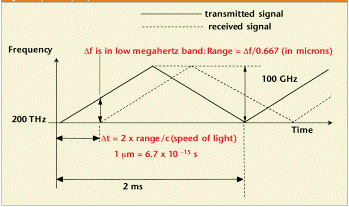

How the technology works
The instrument directs a focused laser beam to a point on the piece to be meas-ured and recaptures a portion of the reflected light. The single large-aperture optical path maximizes signal strength and stability. As the laser light travels to and from the target, it also travels through a reference path of calibrated optical fiber in an environmentally controlled module. Heterodyne detection of the return optical signal mixed coherently with the reference signal produces the most sensitive radar possible. Extensive signal processing extracts the range-dependent signal frequency with great accuracy (see Figure 1). Measurement of the signal intensity and signal-to-noise ratio provides a built-in check that confirms measurement quality. The two paths are combined to determine the absolute range to the point.
Figure 1: Optical Frequency
laser1
MetricVision measures a distance and two angles to determine a point on a surface in space. This instrumentation uses a broadband frequency-modulated infrared laser (100 GHz modulation) that provides a robust, eye-safe signal. The enormous laser modulation bandwidth makes precise measurement possible in a millisecond. The up-sweep and down-sweep comparison provides simultaneous range and velocity data for measurements. Velocity data is important when it's necessary to meas-ure the dynamic response of a structure, i.e., vibration analysis.

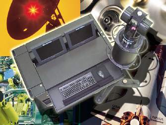

Portable system components
A single sensor mounted to an instrument stand and a mobile workstation that integrates a computer with the laser radar make up the system. The workstation (cart) has two video monitors; one displays application software while the other shows a color video image of the area to be measured.
The stand-mounted instrument and the cart each occupy less than a square meter of floor space, making the system easy to move. The entire system is designed to be transported in a small truck or minivan. The robust scanner head is 40 kg. It integrates precision optics and mechanical engineering with electronics and software. The workstation weighs 190 kg and provides an ergonomic work area from which to control operations and direct the lasers. The eye-safe laser radar is Class I, and the optional red laser pointer is Class II. The cart also houses an industrial computer and modules to operate the scanner and coherent laser radar. The instrument is powered by 110 volts AC but incorporates a UPS to allow for international voltages from 80 to 240 VAC. The MetriVision100B communicates over 10/100 Base-T Ethernet. Its open interface "CLRIC" enables direct software control for embedded applications.
To support a host of different application software, a high-performance Pentium PC and peripherals (including a color printer) are part of the system. Data can be imported into leading third-party software to meet a broad range of inspection, quality assessment, reverse engineering and other special application needs. Software is available inter- nationally from many leading manufacturers, including Silicon Graphics (Alias Wavefront's EvalViewer), New River Kinematics (Spatial Analyzer), Imageware (Surfacer, Inspect It, Build It, Verdict), Perceptron (ScanWorks), Verisurf (all packages), Metris and Paraform.

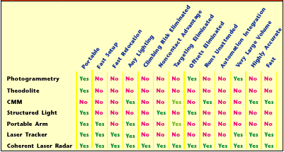

Comparing current technologies
Every tool in the metrology toolbox has value. Further, some visually acute operators have demonstrated better-than-average accuracy with older technology like theodolites. But new instruments can consistently demonstrate the highest accuracies. Figure 2 is an overview of qualitative comparisons that highlight the strengths of coherent laser radar to put this new technology in perspective.
Figure 2: Product Comparisons
laser2
Some differences become evident when comparing current technologies. With the exception of the CMM, all technologies shown are portable--a CMM was included for comparison because few instruments have the high accuracy and speed of a traditional CMM. However, with the ability to measure parts in-situ, portable systems save valuable time making go or no-go determinations at the part. Though unique applications might dictate the use of one particular technology, most applications can be completed with the use of many different technologies. Figure 2 serves to show the versatility of coherent laser radar, especially if a combination of speed, accuracy, safety and labor savings is most important.
