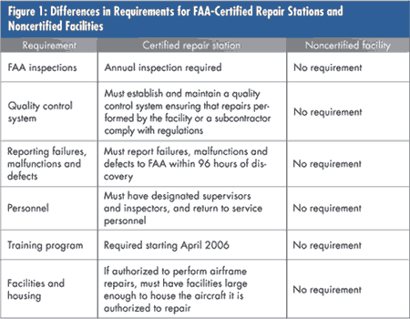

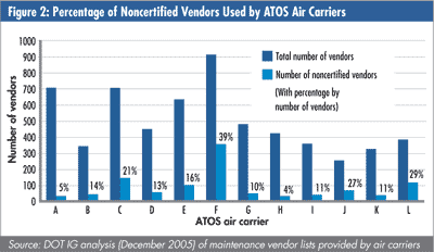

The FAA has responded to these findings, in part, by introducing a risk-based inspection program that identifies those repair stations doing the most work for airlines and monitoring their operations more closely. At present, it is estimated that the FAA has certified close to 4,600 domestic and 650 foreign repair stations. However, in addition to the FAA-certified repair stations, a growing number of noncertified repair stations are performing safety-critical work, according to a December 2005 report issued by the DOT IG. By definition, the work performed by these noncertified repair stations is not overseen by the FAA inspectors. Even though the work performed in such noncertified stations must be performed by FAA-certified mechanics and inspected by FAA-certified inspectors, there is a dramatic difference between the regulatory requirements for certified and noncertified stations, as seen in figure 1 below.
Economic pressures lead to outsourcing
Due to economic pressures, many airlines are outsourcing a growing percentage of their maintenance, repair and overhaul (MR&O) activities. A 2005 DOT IG report estimated that during the past decade, network air carriers have increased contract maintenance from 37 percent of their total maintenance expenses to 53 percent. Furthermore, some of the outsourced MR&O work is being contracted to emerging suppliers, based in countries without a strong history in the aerospace and aviation sectors. Many interested stakeholders are concerned with the FAA's and other NAA's (as well as the airlines') ability to perform adequate oversight of distant repair stations. In these instances, inspectors need to assess the suppliers' technical and technological abilities in addition to their quality management practices, but under the heightened challenge of language and cultural barriers and differences. Figure 2 below shows the number of noncertified vendors approved by Air Transportation Oversight System air carriers to perform aircraft maintenance. It ranges from 4 percent to 39 percent of the total number of maintenance vendors.
