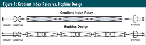

Advances in the optics and illumination of modern borescopes give bright, clear, crisp images that allow definitive decisions. Every borescope has an objective lens to form an image of the subject, relay optics to carry the image from end to end and an eyepiece lens to magnify the image for the viewer. Relay optics are most important to borescope image quality. Rigid borescopes use one of three technologies to relay images:
• Achromatic doublets, which are cost effective in large-diameter borescopes.
• Hopkins design relays, which give excellent quality for medium diameters but require precise grinding, polishing and centering of many tiny lenses and optical glass rods. (See figure 1.)
• Gradient index lenses, which afford the best combination of quality and price for medium and small-diameter borescopes, because the relay optics are simple, chemically treated glass rods. One gradient index rod, for example, can replace 24 optical elements in a Hopkins design scope. (See figure 1.)

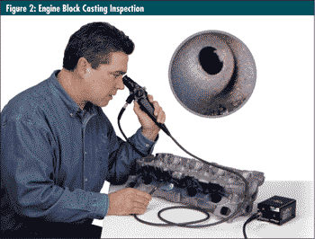

Control of the direction of view is the most important issue, after diameter, when choosing a flexible borescope. The simplest flexible borescopes have a gooseneck sheath that allows you to set the shape before insertion. More expensive flexible borescopes have articulated tips, allowing you to control the direction of the tip back and forth in a single plane (two-way) or in two perpendicular planes (four-way), using levers on the borescope body. You can use the articulation to steer the scope to its destination, then look around. Flexible borescopes allow the inspection of complex castings like engine blocks and turbochargers, tubes, pipes and turbine engines. The best flexible borescopes relay images through bundles of up to 25,000 optical glass fibers. The fibers are acid-leached to separate each fiber from its neighbors, reducing crosstalk between them and increasing contrast for whiter whites and blacker blacks. An impermeable plastic sheath prevents entry of fluids, such as fuel or oil. A tough, durable, woven tungsten wire sheath that reduces friction and protects the scope from damage by burrs and sharp edges surrounds and protects the plastic sheath.
Foundries that cast automotive engine blocks, turbochargers and exhaust manifolds find it very difficult to check for residual sand, blockages, flash or voids because the castings often have complex, inaccessible cavities and winding pathways. They use flexible borescopes that range in diameter from 0.100 in. (2.5 mm) up to 0.5 in. (12 mm). By controlling the articulated tip, they steer the borescope as it snakes through the part.

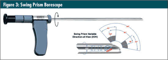

Some rigid borescopes have prisms built into their working ends. Prisms allow alternate directions of view, such as 30°, 70° and 90°, like a mirror tube. Because illumination and imaging are completely independent, prism borescopes are particularly well suited for maximum image clarity and contrast in inspecting large, dark cavities such as those found in diesel cylinders or tanks. Prism borescopes also give "right reading" images, making them easier and more intuitive to control. The prism can even pivot, in the aptly named swing prism borescopes, allowing the user to change the direction of view.
