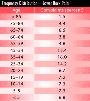

Ismore proves himself correct. Hired as a temporary employee by a government health and demographics agency, he's charged with the task of statistically assessing health risks based on age and geographic data. He has so much data at his disposal that he feels confident that his study cannot fail. He needs only to decide on a particular malady and create a frequency distribution to show how often that problem recurs at various age groups. "This will be a piece of cake," he mumbles to himself as he installs yet another computer game on his laptop.
 The health problem to which Ismore has the most accessible data source is lower-back pain from a variety of causes (including injury). Because almost everyone has had an experience with back pain at some point, Ismore believes that using this symptom will give the data broader appeal. And because he experiences the symptom himself, he's confident that he can relate to the data directly.
 Ismore creates a frequency distribution from the data he has available. "Wow," he says. "This is alarming data." From his chart, he concludes that the age groups that fall between 25 and 54 have up to twice as many incidents of back pain than other groups. "Who would think people that young would have so many problems?" he wonders as he ponders the possibility of publishing his findings: Instant fame. Book signing parties. Cash. He feels smug in his knowledge that Simsack would never get such an opportunity back at old Greer Grate & Gate.
 What common error--the same error made in the May 15, 2001, issue of USA Today in an article on population growth--has Ismore made in constructing the frequency distribution for his data?
 Conclusions based on this frequency distribution will be flawed because Ismore hasn't bothered to determine appropriate intervals for his data; indeed he has created two different intervals, one of five years (i.e., 20-24) and one of 10 years (i.e., 35-44). The number of low back pain incidents in the 10-year interval group would of course be larger than if it had been distributed into five-year groups.

 Ismore's error related to his selection of class intervals. Groups with larger intervals will naturally contain more data simply because they are larger. Any other conclusions are fallacious.
