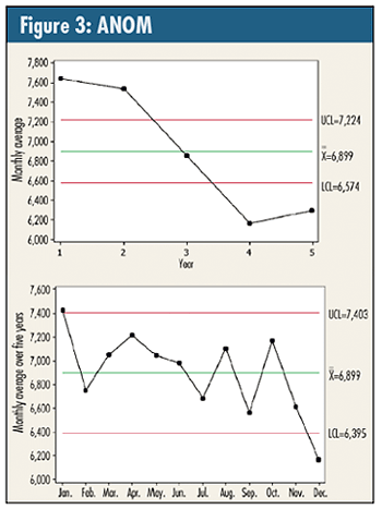

The analysis of means (ANOM) used to compare year-by-year and month-to-month "seasonality" are shown in figure 3. Three standard deviations are used for the limits. (See last month’s column on ANOM limits.)
The top graph confirms what the time plot showed: significant shifts in January of years three and four. If the "plot of the residuals in time order showing no pattern" diagnostic had failed, it would have invalidated the "significant process shift at January" model.
The bottom graph compares the monthly averages. The underlying structure of the standard deviation (i.e., the square root of the "error" term MS in the ANOVA) has inherently "adjusted" for these yearly process shifts so that they don’t interfere with this monthly comparison.
Figure 4 provides a summary table of the twelve monthly averages.
Only because the ANOVA gave a significant result for "month" can one now calculate what is statistically called the least significant difference (LSD), used to interpret the differences in monthly averages. I won’t go through the mechanics because that would distract from the purpose of this column, but suffice it to say that the LSD in this case is 479.
The human tendency is to focus arbitrarily on the largest differences, so there’s another number that adds an element of conservatism and balance. Theoretically, with 12 means, there are 66 pairwise comparisons. So, utilizing the Studentized range to compare any two months, this difference becomes 821.
