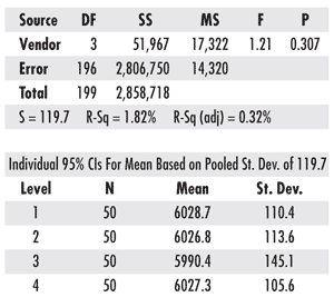

Your company’s statistical guru cautions that the data for vendors three and four aren’t normally distributed: “Vendors one and two both pass the normality test with p > 0.05,” he says, “although vendor four doesn’t quite fail the null hypothesis at the p < 0.01 level.”
His analysis of variance proves no statistical difference among the four vendors with a p-value of 0.307 and confirmed by the overlapping 95-percent confidence intervals:
Given this, should you base your decision solely on price?

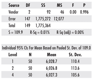

Then again, vendor three wasn’t normally distributed, had the highest overall standard deviation and was the most expensive. Obviously, its estimate of standard deviation is incorrect. So, the analysis is redone with vendor three omitted:
Looks like vendors one, two and four are virtually identical; it all comes down to price.
How many of you do this every day and must make decisions based on such calculations? What do you generally do--and what would you do in this situation?
Then you discover the control chart sent by each vendor with its shipment….
