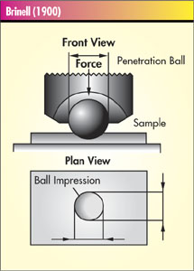

The Brinell method
According to Mark Antonik, hardness testing specialist at Sun-Tec Corp., the Brinell hardness tester first appeared on the market sometime near 1900.
Scott Robinson, a technician at The L.S. Starrett Co., elaborates. “Basically, a Brinell tester uses a round ball indenter to press into a piece of metal with a known force. That force will cause a dimple in the part. The harder the material, the smaller the dimple.” Once the dimple is established, it’s measured, and that measurement is assigned a certain value, as illustrated.
The problem with Brinell testers, however, is that the round ball indenter doesn’t necessarily make a clean, perfectly round indentation, making it difficult to measure exactly how hard the material really is.

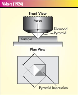

Along comes Vickers
Sometime around 1924, the Vickers hardness tester was developed.
The difference between a Brinell and a Vickers hardness tester is the type of indenter used. Where Brinell uses a round ball indenter to press materials, Vickers utilizes a square or diamond-shaped indenter. It’s the same basic principle as the Brinell, but the user has a device to measure more defined indentations rather than Brinell’s harder-to-determine round indentation. (See illustration.)

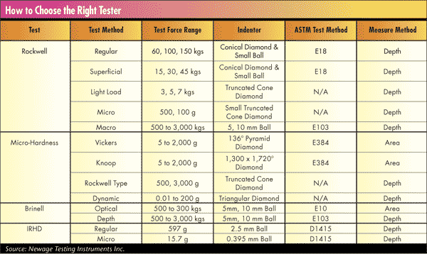

Choosing the right tester
According to Newage, there are several questions that need answering before choosing the right tester. These include:
Is there a hardness scale specified (Rockwell, Vickers, Brinell, etc.)?
What is the material being tested, and is it suitable for a particular test?
How large is the part?
What volume of testing has to be done?
How accurate do the results need to be?
What is your budget?
What problems have occurred in the past?
For a more in-depth look at how to choose the right tester for your application, see the chart below.
Testing considerations
Newage offers some general tips to help your hardness testing experience go smoothly. Among these considerations are:
Large parts. Parts that aren’t easily supported on an anvil should be clamped into place or properly supported.
Small parts. The smaller the part, the lighter the load should be. Meet the minimum thickness requirements and properly space the indentations away from edges.
Cylindrical testing. A correction to a test result is needed when testing on small-diameter cylindrical shapes due to a difference between axial and radial material flow.
Space indentations. Maintain a spacing equal to 2.5 times the indentation’s diameter from an edge or another indentation.
Thickness. Maintain material thickness at least 10 times the indentation depth. n Scale conversions. Sometimes it’s necessary to test on one scale and report on another. Conversions have been established by the American Society for Testing and Materials, but unless an actual correlation has been completed by testing on different scales, established conversions may not provide reliable information.
Gage R&R studies. In hardness testing, there are variables that preclude using standard gage R&R procedures with test pieces. Material variation and the inability to retest the same area on depth measuring are two significant factors.
