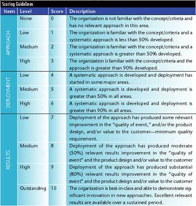

QSA scoring guidelines
 Now that we've reviewed some of the overall goals, roles and responsibilities for a typical design review, let's examine the QSA process. The intent isn't to give a cookbook approach but rather a series of guidelines for what's important and how to evaluate the design review for optimum results. It's important to recognize that each design review is unique—as is each organization—and these reviews must be thought out completely.
 The very general scoring guideline format shown on page 28 demonstrates the scoring process. Scoring may be used to establish a baseline and measure performance improvement relevant to the QSA. The scoring may be performed as a self-assessment by an individual or organization, or by peers. The actual cutoff point will depend on a consensus by the individuals involved and, for obvious reasons, is organization- and product-dependent.

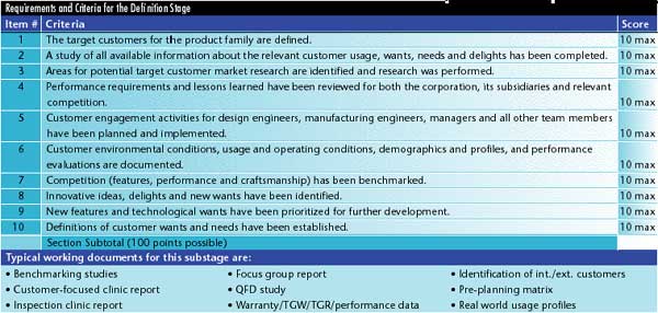

Defining product and process
 The objective here is to establish or prioritize customer wants, needs, delights and so on. Therefore, the requirements are to identify customers and establish or prioritize these wants, needs, delights, real-world usage profiles and demographics. To do that, points are developed for each question and weighed against both each other and the other subcategories. (See page 28.) The actual numerical scheme isn't as important as the differentiation and understanding of the questions asked. In our example on page 28, each question is given 10 points for a total of 100 subsection points. A minimum score of 60 is expected, but a good score is anything higher than 85.

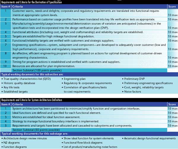

 The second subsection of the definition stage is deriving the customer-driven specification—purely an engineering task. The requirements here are to translate customer, corporate and regulatory functions; make appropriate trade-offs; and establish product or process specifications (i.e., requirements) and engineering test plans. The specific criteria are shown below. Note that each item is again weighed on a 10-points-per-question rating for a total of 100 points. Here, too, the actual numerical values aren't as significant as the rationale and weighing process for differentiation. Any numerical scheme can be used, as long as the outcome satisfies the objective. A minimum score of 70 is expected. Items one and two must have a minimum value of nine points each. Again, a good score is anything higher than 85.
 The third subsection of the definition stage is defining the system architecture and function. This, too, is purely an engineering task. The requirements here are to define system architecture, inputs/outputs and ideal function for each system element, and also to identify interfaces. Interfaces are very critical in the ultimate design because they present challenges from interaction. The classical interface opportunities are due to the physical proximity of different items, information transfer, different material compatibility and energy transfer.
 The specific criteria for this subsection are shown at the bottom of page 30. Note that each item is weighed on a 10-points-per-question scale for a total of 50 points. Again, the actual numerical values aren't as significant as the rationale and weighing process for differentiation. One may use any numerical scheme as long as the outcome satisfies the objective. In this case, a minimum score of 30 is expected. Questions two and three must have minimum values of nine points each. A good score is anything higher than 40.
