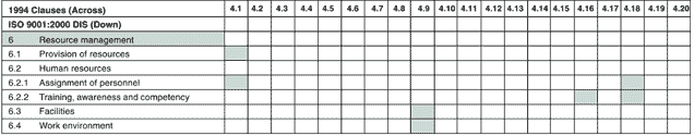

 For a quick guide to locating resource management elements from the 1994 version in the ISO 9001:2000 draft international standard (DIS), see Figure 1.

Figure 1: ISO 9001:1994 Resource Management Clauses
Cross-Referenced to the ISO 9001:2000 DIS
