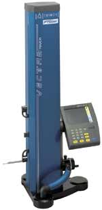

Fowler's Trimos Series Electronic Height Gage

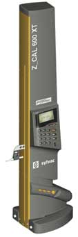

Fowler's Z-Cal Motorized Height Gage

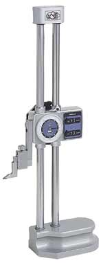

Mitytoyo's Digital Counter Type Height Gage

During the 1970s, dial calipers began to emerge as "easier to read" tools. Dial height gages quickly followed. The dial height gage features a round-faced dial with an arrow pointed toward graduations that indicate height. "It was much faster and as accurate as the Vernier height gage," notes Robinson.
The mid-1980s were a time of technological growth, during which the first electronic height gages emerged. Instead of manually operating the gage and reading a dial indicator, electronic reading tools, like touch-trigger probes, can capture the exact measurement of a material and translate it onto an LCD screen.

• Dial height gage. An analog-reading height gage featuring a round dial attached to the slide. The dial reads graduations of measurement, and the user adjusts position manually.
• Digital dial height gage. Like a dial height gage, but with a counter for more precise measurement. For example, the counter will read to tenths of an inch, and the dial will read to one-thousandths of an inch.
• Electronic digital height gage. A height gage featuring a digital display of measurements. These units can also include features such as instant inch-to-millimeter conversion, a hold option that temporarily saves your measurements and the ability to set any position to zero.

Schuetz stresses that the best height gages will have as little operator influence as possible. "They should have the capability of being motorized so that they always test the part with the same force," he says. "Part programming for repetitive operations is a must."
