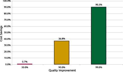

 Did accounting make a mistake? In a word, no. The problem arose because Sam measured quality as defects. The truth is that most costs are incurred because of defectives rather than because of defects. (Thanks to Mikel Harry of the Six Sigma Academy for this insight.) A defective is a unit of product or service that contains one or more defects. Whether a unit contains one defect or several is irrelevant. Customers generally react to defective units by returning them for warranty repair, refunds or other options. Internally, defective units must be identified through costly inspection and then routed through equally costly rework processes, or else scrapped entirely. A unit with one defect costs nearly as much as one with several.
 Mathematically, the Poisson distribution describes the relationship between defects and defectives. The equation for the Poisson distribution is
In the equation, x represents the number of defects in the sample, and P(x) means the probability of finding x defects. For example, P(1) is the probability of finding one defect. The symbol m is the average number of defects per unit of product or service. For Sam's project, the average assembly had 10 defects before six sigma was applied, so m = 10. The efforts of the six sigma team reduced the average number of defects per assembly to 5, for a 50 percent improvement in quality.
 Let's plug these numbers into the equation and see what happens. Because we are interested in the probability of an assembly being defect-free, we want to know P(0) for each of the two quality levels. Before six sigma, with m = 10 we get
In other words, there were virtually no defect-free circuit assemblies before applying six sigma methodologies. After applying six sigma, the probability of getting a defect-free assembly at Acme was
 Thus, a 50-percent improvement in the quality level as measured in defects produces only a 0.7-percent improvement in the number of defect-free circuit assemblies. A complete graph of this relationship is shown in Figure 1.
Figure 1: Quality Improvement vs. Cost Savings
 The real cost-reduction benefits only start to appear when quality reaches very high levels. This relationship explains the commonly observed phenomenon of quality programs not paying off in the short term. Only when companies stick with it long enough to begin to approach six sigma quality levels do they get the desired results. Too often, "toe in the water" projects scare companies out of the pool before they even start to swim.
