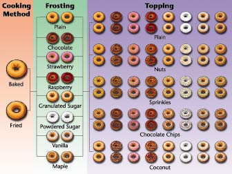

 Then Chris comes out with a picture. Great, Joe thinks; he wants to make doughnuts and his daughter wants to make diagrams. But some of what she says makes sense. Joe takes another look at her diagram, shown in Figure 1.
Figure 1: A Three-Stage Process with 13 Elements
Chris points out to her dad that he doesn't have 80 different products; he has a three-stage process composed of 13 process elements: the two cooking methods, the eight frostings and the five toppings (2 + 8 + 5 = 13 elements). The process has 80 different paths (2 x 8 x 5 = 80), but all paths go through the same three stages.
 To control this process, Joe needs to study the cooking methods, the kinds of frostings and the kinds of toppings.
 Joe has already done some of this work. His concerns about the proper temperature of the chocolate and the kinds of nuts used are appropriate, but there are 16 different products that use nuts: baked doughnuts with strawberry frosting and nuts, fried doughnuts with vanilla frosting and nuts, and so forth.
 However, by breaking out the steps used to make the doughnuts, Chris has turned a daunting problem into a manageable one. Joe can now perfect his process through more in-depth study.
