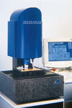

For the production sector, state-of-the-art machine vision systems incorporate fast, high-resolution CCD cameras coupled with intelligent frame grabbers that allow multiple-image processing. These advanced systems combine with optics to allow the finest resolution possible.
Image resolution, not necessarily magnification, is the main factor in measuring accuracy. The video-image processor and driver software are key elements in how much can be analyzed and how fast.
As production machine vision roles change, so must the systems. Firmware and software capabilities are changing the quickest. A future hardware change will incorporate high-speed auto focusing to increase capabilities and accuracy even more. For now, however, two-dimensional stand-off measurements for production are the norm.
For the metrological world, state-of-the-art vision systems include those that measure in 3-D and offer powerful analytical processors and software.
Metrology labs don’t require the same throughput as production, although they do require more capability. Therefore, metrology must have the tools to measure whatever production can and at a significantly higher degree of accuracy.
Ultimately, metrology requires the tools to thoroughly analyze production parts or prototypes in full 3-D and relative to part datums. If this is not possible, then the production measurements have no real basis against which to be compared.
As sensors technology continues to push forward, the use of multiple data-acquisition devices will become more commonplace. Production departments will incorporate scanning lasers with vision and/or mechanical contact. The intelligence and flexibility of the vision processors will make possible a handoff of the required information to the alternate sensor for it to perform its functions, thus taking production one step closer to 3-D measurements.
This technology already exists for metrology labs, which combine noncontact 3-D measurements with contact measurements to ensure all measurements are in reference to part datums.
But the proof of any technological advancement is in its usage. The world’s largest supplier of machine tool inserts currently is using on the shop floor machine vision systems with automatic feature recognition. They offer 0.8 micron-per-pixel optical resolution, high-speed digital scanning and automatic geometry measurements to control production of cutter inserts in a grinding environment.
As process geometry changes, the vision system automatically feeds the correction data to the grinders for real-time part geometry correction. In this company’s metrology lab, duplication as well as excess inspection capability is in place to set and correlate each online inspection system.
