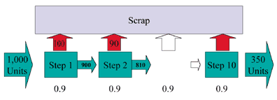

 Peter studied the report for a moment and then nodded. "Let me show you what's going on," he said as he picked up a marker and drew a diagram (see Figure 1).
Figure 1: Process with 10 Steps
 "This process has 10 separate steps," Peter began. "Each step has a yield of about 90 percent. This is the unit yield for that process step."
 "Right," Sam interjected. "And all of them are about 90 percent, so the average yield for the whole process should be about 90 percent."
 "Yes, but that isn't the number you need if you're trying to determine the final yield for the process," Peter responded. "Final yield is the proportion of defect-free units out of the final process step relative to what you started with at the first process step."
 Sam nodded. "Yeah, but even though the average yield is nearly 90 percent, our final yield is nowhere near that high."
 Peter turned back to the board. "Here's a mathematical model of what happens when all process steps have the same unit yield." He wrote an equation:
 Yoverall = (Ystep)number of steps
 "The unit yield at every step is about 0.9, but you have to multiply the step unit yields together to get the final unit yield. You can't just average them," Peter explained. "Think of a simple two-stage process. You start 100 units at the first step and 90 pass. These 90 start the second step and 90 percent of them pass, leaving 81. The average unit yield is 90 percent, but the final unit yield is only 81 percent."
 "So for our 10-step process…," Sam began.
 Peter punched his calculator keys. "0.9 raised to the 10th power is about 0.35. So 35 percent is your predicted final yield."
 "And that's pretty close to what we're getting," Sam said.

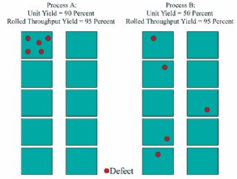

 Peter sketched another picture on the board (see Figure 2).
Figure 2: Unit Yields vs. Rolled-Throughput Yield
 "Let's assume that we have two lines making the same product. If we only look at unit yields, they look much different. One process has a 50-percent yield, the other a 90-percent yield. But assume that each unit had 10 critical-to-quality characteristics. If we look at characteristics, we see that both have produced five defects in 100 defect opportunities. In terms of the ability to produce defect-free quality characteristics, they're actually the same."
 "So if it costs $100 to fix a defect, the two processes have about the same rework cost, even though the unit yields would make the first process look a lot better," Sam replied, nodding.
 "This is exactly why we use rolled throughput yields in six sigma," Peter responded. "They correlate much more closely with labor, cycle time, rework costs and other important management metrics."
