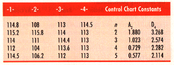

The second major type of control chart is used when the data have been arranged into subgroups. Here we are typically concerned with data where several values are obtained in a short period of time. For example, an auto plant in Portugal received shipments from a supplier in Germany. The part was a piece of wire for connecting the horn buttons to steering wheels. These wires were supposed to be 100 mm long. Every time they received a shipment, the Portuguese selected five wires and measured the lengths. The data for the first four shipments and a table of control chart constants are shown below:

With subgrouped data, we plot the subgroup averages and subgroup ranges. Therefore, we must begin by computing averages and ranges for each subgroup. For each shipment, the average of the five values will be the subgroup average. The range of a subgroup will be the difference between the maximum value and the minimum value in that subgroup. For the first shipment, the maximum value is 115.2, while the minimum value is 112. Thus the subgroup range is: 115.2 ­p; 112.0 = 3.2 units.

The average of the subgroup averages is obtained. This value is called the grand average. Here the grand average is 112.45. This value will be the central line for the upper portion of the chart.
The average of the subgroup ranges, called the average range, is also obtained. Here the average range is 4.725. This value will be the central line for the lower portion of the chart.
The control limits for the average and range chart are computed using the grand average and the average range. The upper control limit for the average chart will be:
Grand Average + (A2 times Average Range)
= 112.45 + (0.577 x 4.725) = 115.2
The lower control limit for the average chart is:
Grand Average ­p; (A2 times Average Range)
= 112.45 ­p; (0.577 x 4.725) = 109.7
The upper control limit for the range chart is:
D4 times Average Range = 2.114 x 4.725 = 10.0
where A2 and D4 are the appropriate control chart constants for a given subgroup size. They are those values which allow us to convert the grand average and the average range into control limits.

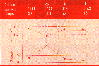

As may be seen on the average and range chart, one average and one range fall outside their limits. Shipment Two has a lower average and a greater range than the other shipments. Due to the way the data were arranged into subgroups, the average chart characterizes each shipment's location-the average length of the wires in that shipment, while the range chart characterizes each shipment's consistency-the dispersion of the lengths of the wires in each shipment.
Clearly, the four shipments have different locations and dispersion. Moreover, since the target is 100 mm, all shipments were far above the target. Based on this record of inconsistency, both within and between the shipments, the German supplier was dropped. The other suppliers were much more consistent in the product they delivered.
