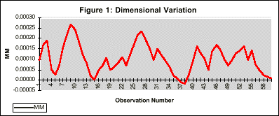

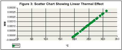

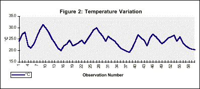

Step 3 Upon completing 30 to 60 recorded observations, tabulate your data and compile graphs, as in figures 1 and 2, which show dimensional measurements of the test part and respective temperatures over the test period. Look for correlations between dimensional and thermal variations. Where a single temperature measurement series (e.g., work piece temperature only) exhibits a direct linear effect on dimensions, a scatter chart similar to Figure 3 may reveal that relationship.
Step 4 If you see from these data that temperature affects your measurements, the final step is to quantify the error. Simply determine the range of dimensional variation. If you work with tightly toleranced dimensions, remember that it is generally considered good practice to maintain gage R&R at 10 percent or less. Compare the amount of observed dimensional variation in your test against the tolerance on the test part. If you conclude that temperature produces an unacceptable effect on your measurement system, take steps to address the problem. Simple solutions exist today; temperature compensation systems are available at reasonable prices. In some cases, these systems can substantially improve your process capability and overall quality, saving you the expense of installing sophisticated air conditioning or coolant chillers.
