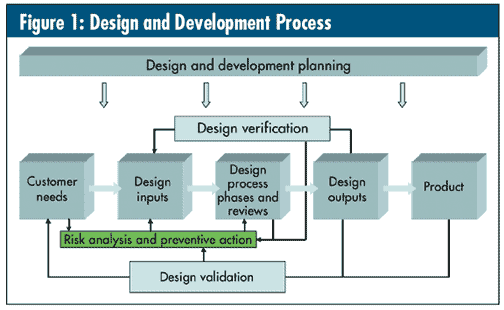

The overall product design and development process is shown in figure 1, below. The only part of the diagram that isn't affected by subclause 7.3 is the box related to risk analysis and preventive action, which is addressed by subclause 8.5.3.
It's important to determine how to use design review, verification and validation as input for risk analysis and developing preventive actions. For example:
• Design review . Design review is normally conducted at various stages during the design process; it's one way to address issues such as product dependability and service reliability related to the product. It's critical to consider the importance of producibility and service-delivery capability as appropriate. Identifying issues in these areas early on will enable the organization to avoid surprise capital needs and dramatically cut introduction costs.
• Design verification. Verification is simply a comparison of design output to input requirements to make certain that the development project is on track.
• Design validation. Validation is a confirmation that the product will meet actual application needs. This is best conducted directly with users and may involve having them use product prototypes or development models. For services, it may involve test sites where the service is piloted with actual clients. Feedback from users can be critical in making the best final product design decisions. When users provide negative feedback, you have a golden opportunity for designers to use their innovative talents to develop customer-friendly solutions.
