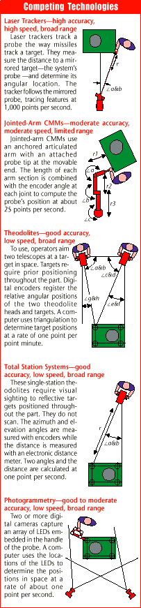

 Laser Trackers
rectrectrectrectrectrectrectrectrect Picture
Picture Picture
Typical Applications for
Laser Trackers
