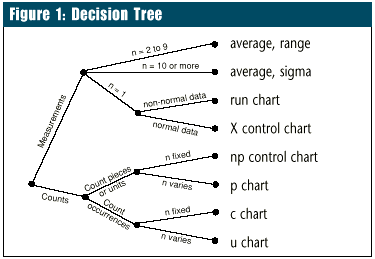

Phil nodded and took a graphic out of his desk drawer and showed it to Joan (Figure 1). "Remember this?" he asked.
"Sure," replied Joan. "It's the decision tree for finding out which control chart to use."
Phil smiled and nodded. He liked teaching and found it especially rewarding when bright students like Joan applied what they had learned.
"But it doesn't work for my data," Joan continued.
Phil's smile faded. "What do you mean? It has to work." He turned the paper toward her. "Here, let me show you." He placed his finger on the dot at the left of the chart. "Are we dealing with measurements or counts?" he asked.
"Counts. They count the number of invoices with errors."
Phil ran his finger along the line labeled count until it reached the next dot. "OK, are we counting pieces or units, or are we counting occurrences?"
"Pieces or units. They count invoices, which are pieces of paper."
"And the last question is: Does the sample size stay the same, or does it vary?" asked Phil.
"It varies," said Joan. "Every month a different number of invoices are processed."
"Then the correct chart is the p chart," concluded Phil, tapping his finger on the graphic with an air of finality.

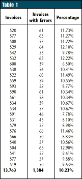

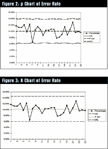

Assume that Joan has the number of invoices and errors shown in Table1. Figures 2 and 3 show, respectively, the p chart and the X chart for these data. The X chart was created by using the percentages as if they were measurements. The conclusions are the same with either chart: The process is in statistical control. Table 2 shows that the numbers calculated from the data are close, too.
In other words, if all that are available are the percentages, the X chart provides an excellent approximation to the p chart. The same conclusion applies to data for the np chart, c chart, u chart, sigma chart, etc. In all these cases, and more, the Swiss army knife of control charts allows the process operator to focus on data. One could even argue that the simplicity of using a single chart instead of several charts outweighs the mathematical advantages in many cases. So, when in doubt, get the X chart out.
