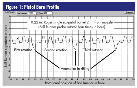

Profiling gun bores. This technology offers substantial capabilities for profiling pistol, rifle and large-caliber artillery bores. Probes can easily be manufactured so that they're of any length and diameter, from 0.150 in. to several inches, if required. Further, given the technology's capability to make reliable measurements down to the micron level, it can be used to perform a gage measurement on the bore and record the measurement as a dynamic profile in a digital format. Thereafter, when the weapon is fired, the technology can also perform a reverse profile on the projectile. This allows the bore's profile and the projectile to be correlated so that proof of the projectile's origin can be established.
In addition, the entire bore can be profiled to inspect the characteristics of its rifling. After the bore's profile has been recorded, the system software can be used to open the bore so that its interior is shown as a 3-D model on the screen. Limits can then be placed around this profile to determine if the bore is within spec. The software allows the bore profile to be sectioned so that any portion of this 3-D bore can be viewed as a 2-D cross section. This cross section can then be manipulated to allow viewing and measuring of any portion of the bore.
A system of this type can also measure bore wear after the weapon has been fired a number of times. A bore profile in its "as manufactured" condition can be stored and, using an overlay process, compared to the same bore after the weapon has been repeatedly fired (as seen in figure 1). This comparison will yield information about the degradation of the bore caused by the firing events it was exposed to. Additional software, still under development, would allow bore wear not only to be predicted but also superimposed on the profile so that it can be viewed in a worn state.

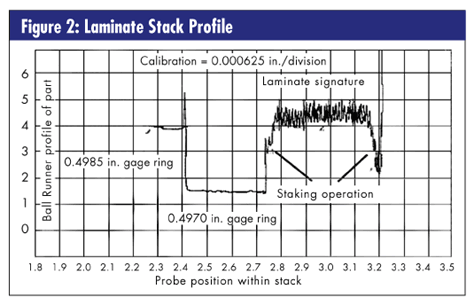

Precision measurements of holes in laminate stacks. Precisely measuring holes in laminate stacks presents challenges for any measurement technique. Because laminate stack holes are noncontiguous, and the laminates' absolute alignment is one of the parameters that typically must be measured, even pin and plug gages have difficulty properly measuring the inside diameter of the bore. The Ball Runner probe, however, has no problem with noncontiguous holes and in fact excels in making precision measurements in holes created from separate pieces of material.
As shown in figure 2, the profile of the laminate stack depicts not only the individual laminates but also the presence of the swaging operation used to decrease the diameter of the last few laminates so that the stack can be properly pressed onto a shaft. It also allows the stack to be checked to ensure that it contains the correct number of laminates. This can be accomplished in two ways. First, the stack's width can be seen on the X-axis. This width varies directly with the number of laminates in the stack. Second, by counting the number of transitions of the laminate indications, the actual number of laminates in each stack can be counted.

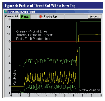

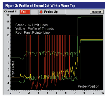

Worn tap predictions . Taps used to thread holes are usually changed based on a calculated change cycle. This cycle relates to the type of material being tapped, the type of tap used, the tap speed, the type of coolant used and other parameters specific to the application. In reality, this calculation is only slightly better then an educated guess. A much better way to approach the problem is to use the probe to profile the threads after the tapping operation has taken place and set limits that relate to the thread characteristics created by a worn tap. As the tap wears, a measurement of the wear condition taken from the part that's actually being tapped can be fed back into the manufacturing process. By default, this feedback loop can eliminate scrap from a tap that's actually creating malformed threads. (See figures 3 and 4.)
Two excellent examples support this approach to scrap reduction. In one case, a tier one supplier to General Motors uses this technique to eliminate scrap in a sintered metal transmission part. In the second case, a division of GM uses this technique to reduce scrap in a screw-machine part within a fuel-delivery system. In both cases, this means of measuring the degradation of a tap has superseded periodic tap replacement based on a calculated replacement cycle.
