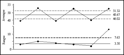

With our simple data set the median range is 3.50. With the scaling factors of A4 = 0.758 and D6 = 2.375 and the usual formulas we find the limits in figure 3. All six subgroup averages and one subgroup range fall outside these limits.
Figure 3: Average and range chart based on median range

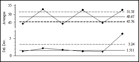

With our simple data set the median standard deviation statistic is 1.511. With the scaling factors of A10 = 1.689 and B10 = 2.351 and the usual formulas we find the limits in figure 4. All six subgroup averages and one subgroup standard deviation fall outside these limits.
Figure 4: Average and standard deviation chart based on median standard deviation
Thus, with only slight changes in the details, approaches 1, 2, 3, and 4 tell the same story about our simple data set. Because of the slight inflation in approaches 1 and 2, the alternate approaches 3 and 4 are more sensitive in this case.
