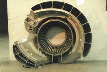

This photo shows a bypass engine duct in its “before” state, how many ducts were not lining up correctly with the mating components before this reverse-engineering process took place. |
Mission Support essentially remanufactures the bypass ducts of the B-52, often performing a complete disassembly and reassembly during overhaul. Most of these engine ducts have been in operation on the aircraft for more than 30 years and many are misshapen, corroded, or distorted; and using the original hard tooling to rebuild them proved to be a nonviable option.
Even though they often have the original hard tooling and fixtures from the original equipment manufacturer (OEM), these tools are cumbersome and less accurate than required, and the associated Mylar data is incomplete. This makes it difficult to reconstruct the needed parts because the older tools lack the accuracy needed to locate the critical attach points to be within the OEM drawing tolerances. Also, a lot of the upstream and downstream tooling originally used by the manufacturer to create these parts simply does not exist anymore. Even so, without a better alternative, this old tooling was used for years to overhaul these structures.

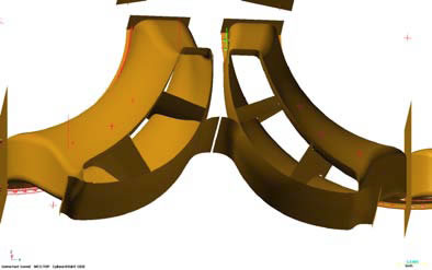

Reverse engineering the original master molds into CAD
Reverse engineered solid models of all six (LH and RH) bypass engine duct configurations. |
Solution
The first step to solving these problems was to convert the existing technical data into a CAD format utilizing reverse engineering. Mission Support conducted dimensionally accurate scans of the available Mylars. Utilizing a FaroArm portable coordinate measuring machine (CMM) with Verisurf CAD software in “reverse engineering mode,” Mission Support generated point cloud profiles of the old master molds. They then hand entered as much data as was available from existing tooling drawings. This effort produced 3-D CAD solid models for all six duct configurations. Mission Support then calibrated the original assembly fixtures and subsequently revamped manufacturing of the ducts themselves, eventually incorporating CAD/CAM technology at every level of their production process. These implementations effectively solved the fit problems for all of the critical attach points and contours that were being encountered by the Air Force in the field.
