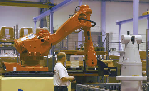

ABB has two adjacent work cells for calibrating robots, each of them measuring 10 x 10 meters. Between the cells stands a Leica Laser Tracker. The operator controls the measurement phase from a PC that is situated to allow him a full view of both cells. While he is measuring a robot in one cell, his colleagues can use the time rigging up or putting away a robot in the other cell. After the robots are measured and calibrated, they are packed and ready for delivery to the customer
A Leica Laser Tracker can follow a movement of 6 m per second with an acceleration of 2G and measure 1,000 points per second. The accuracy of 0.01 mm per meter suits ABB’s work in supplying robots with lifelong position accuracy.
