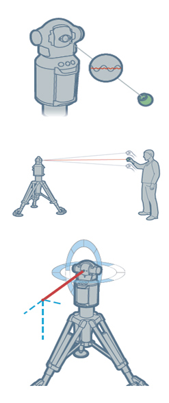

The operation of a laser tracker is easy to understand: It measures two angles and a distance. The tracker sends a laser beam to a retro-reflective target held against the object to be measured. Light reflected off the target retraces its path, re-entering the tracker at the same position it left. Retro-reflective targets vary, but the most popular is the spherically mounted retro-reflector (SMR). As light re-enters the tracker, some of it goes to a distance meter that measures the distance from the tracker to the SMR. The distance meter may be either of two types, interferometer or absolute distance meter (ADM).
A laser tracker contains two angular encoders. These devices measure the angular orientation of the tracker’s two mechanical axes: the azimuth axis and the elevation (or zenith) axis. The angles from the encoders and the distance from the distance meter are sufficient to precisely calculate the center of the SMR. Because of the spherical design of the SMR, its center is always at a fixed offset distance with respect to any surface being measured, so the coordinates of surfaces or points measured with the SMR are easily obtained. Distance measurement, an important function of the laser tracker, can be either incremental or absolute. Incremental distance measurement is made with an interferometer and a frequency-stabilised, helium-neon laser.
The laser light splits into two beams. One travels directly into the interferometer. The other beam travels out of the tracker, reflects off the SMR and, on the return path, passes into the interferometer. Inside the interferometer, the two beams of light interfere, resulting in a cyclic change each time the SMR moves closer to or farther from the tracker by a distance equal to one quarter of the light’s wavelength (~0.0158 micron). Electronic circuitry counts the cyclic changes (known as “fringe counts”) to determine the distance traveled.

Another tracker function is beam steering and control. One type of tracker launches the laser beam directly from its rotating structure. Another type of tracker reflects a laser beam off a rotating mirror. In either case, the tracker points the laser beam in the desired direction by rotating the mechanical axes. In many applications, the tracker keeps the beam centered on a rapidly moving SMR. It accomplishes this by splitting off part of the returning laser beam to a position-sensing detector (PSD). If the laser beam strikes the SMR off center, the split-off beam also strikes the PSD off center, creating an error signal. This signal controls the mechanical axes’ rotation to keep the beam centred on the SMR.
