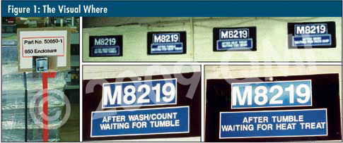

At the very top of the value stream, long before you see a quality part, subassembly, or final product, you’re faced with the first vital question: Where’s the right material? Where’s the correct work in progress (WIP) located? If you don’t know for sure and choose the wrong material instead, the possibility of a quality outcome vanishes. Figure 1 below shows visual devices that help us know where the material we are looking for is, quickly--or steers us away from the wrong stuff. I call these examples of the “visual where.”

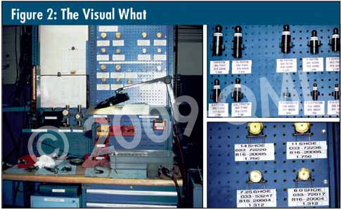

What exactly are we supposed to be making next? Do we know precisely, or do we have to guess and take the chance of producing something that wasn’t ordered? If there’s the slightest chance that we’ll select the wrong material, let’s put a visual device in place to make sure that doesn’t happen. Figure 2 below shows an excellent example of this principle.

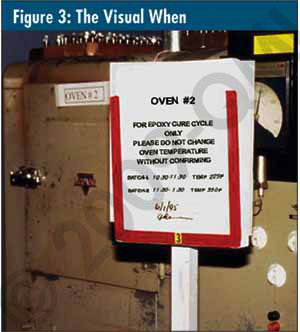

The term “when” in this core question refers to both the exact time something must or will be done, such as “When will this order be completed?” or, “When does this order need to be shipped?” “When” can also refer to the duration of time--the time required, for example, for a heat cycle, as seen in figure 3, below.

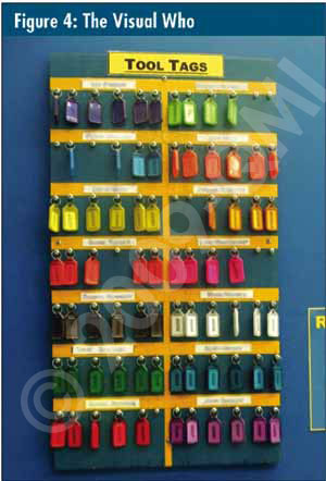

On any given work day, dozens if not hundreds of people contribute some part of their work to make your work happen. Name them visually so you can get back to them for clarification, trace the status of material, find a needed tool, update them on changes, or simply say thank you.
When you consider the visual who, include the tools and machines that act as agents or helpers in the work for which you’re responsible. Make that connection visual as well. It’s all part of a quality outcome--the right quality, right cost, and right time, all done safely.
No doubt you can think of dozens of visual applications. Figure 4, below, illustrates a favorite.

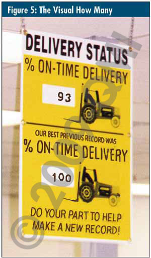

Hands-on counting and measuring are only one way to determine the number, size, volume, or quantity of things, or simply the required setting. Yet there are other ways--visual ways--that are easier, more reliable, accurate, and effective, and don’t rely on judgment or chance.
When we target a visual response to the fifth core question of how many, we build the right answer into the physical workplace so that it resides there permanently for reference as we need it, as seen in figure 5, below.

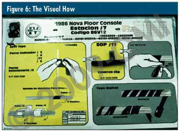

Reliable standards are the bedrock of all work. The “how” of operations (“How do I make it?” “How do I do it?”) is quite simply your standard operating procedure. There are dozens, hundreds, even thousands of standard operating procedures in action on your production floor every day. That’s a lot to remember. Less-than- photographic exactitude can lead to mistakes that can have a severely negative effect on people and the business.
By now you can guess the solution: Make it visual. Just be sensible: Only newcomers need a visual standard for every operation. Once you understand the fundamentals, use visual standards to remind yourself of details you might forget or have forgotten. The key here is to focus your visual standards on specific quality challenges, as seen in figure 6 on below. Effective use of visual standards helps us retain that focus on the tricky bits--not every single tiny little thing.
