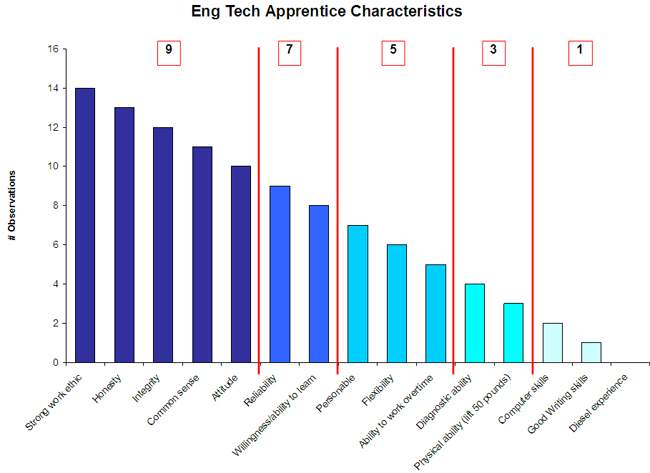

Once recruiters determined what to look for in a candidate, they wanted to understand the relative importance of each input. To do this, they utilized a pair-wise comparison based on near consensus rankings. A pair-wise comparison forces the participants to rank each item against the others in a series of A-B comparisons. While several items may be deemed critical, this tool forces the team to choose which items have a higher priority (even if the relative difference is negligible).
This tool is excellent for small groups (five people or less) when all team members willingly participate. One risk with this tool is that a dominating personality may unduly influence the outcome. If that starts to occur or if you see a pattern of a team member or two not speaking up, you may need to use some method of hidden voting so all opinions can be understood.
For larger groups, other tools are recommended to ensure that everyone’s opinion is heard. One method is for each participant to do a pair-wise comparison individually, and then combine the rankings from all of the participants. Another tool that can be used to prioritize needs is a multivote technique. With this tool, participants get a certain amount of votes to use on the various options. They then assign points to each option based on their perception of relative importance. Oftentimes, it’s a good idea to set a maximum number of votes that an individual can use for one item to ensure that a strong opinion doesn’t skew the results. This is a good method to quickly understand the factors that are critical and weed out the less important minutia.
Here is how the pair-wise comparison for this example turned out in the case of Mercury MerCruiser:
By utilizing a Pareto diagram, the recruiters were able to group the characteristics by relative importance. They used a 1, 3, 5, 7, 9 rating system with the higher number being of greater importance to allow for delineation between the characteristics.

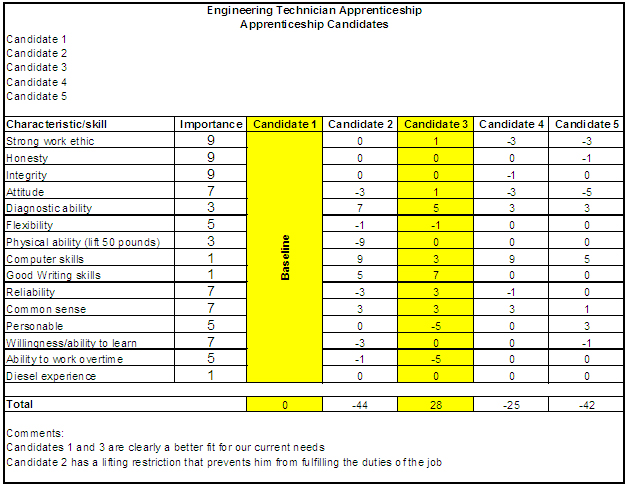

Once the characteristics were prioritized, they utilized a Pugh matrix to determine the relative rating of each candidate with respect to each characteristic. Again, they used an odd number 1–9 rating system (with negatives and positives) to rank how each candidate compared to the others on each characteristic. They then chose one candidate that they were familiar with as the baseline, and the +/- 1-9 ranking system allowed them to compare against this baseline candidate and against all other candidates at the same time.
A Pugh matrix is an excellent decision-making tool when there are various concepts or options that need to be evaluated against one another, based on multiple requirements or items. Benefits include identifying the relative strengths and weaknesses that each option has. Where applicable, this can be an excellent tool to develop hybrid solutions to complex problems as the team draws from the strengths of various concepts.
When using a Pugh matrix, you should be aware of biases that people bring with them when completing the matrix. If someone on the team knows which factors have the biggest effect on the decision, they may artificially or intentionally inflate the scores on those issues for the concept they personally favor. To minimize this, it’s best to randomize the decision criteria and hide the importance factors and the total scores. Here is the Pugh matrix shown with the scores hidden.
Hiding the relative importance and the total scores allowed the recruiters to have an open and honest discussion about each candidate, and they could share their perceptions of how the candidates relate to one another with respect to each characteristic. Once the scores were agreed upon, one of the recruiters revealed the relative importance of each factor, as well as the total score for each candidate.
It should be noted that a Pugh matrix may not be a definitive tool (i.e. you may not necessarily choose one concept just because it has a slightly higher rating than another). The intent is to quickly differentiate the stronger concepts from the weaker ones, and to give a directional view of the options. In the case of this example, the top two candidates clearly stood out among the group.
