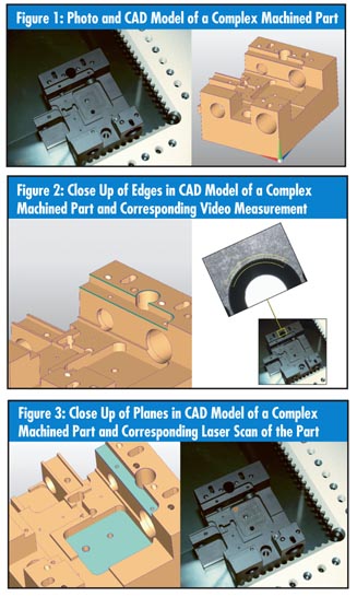

Figure 1 shows a complex machined part and its corresponding CAD model. Selection of sensors depends on the features to be measured.
Assume that the blue-highlighted edges in the CAD model seen in figure 2 need to be measured to determine the relationship (distances) between them. Either of those edges can be assumed to be the intersection where perpendicular surfaces meet. In such a case, a touch probe can collect data points on each of those perpendicular surfaces. The software then fits those sets of points to planes and intersects the planes. Those intersections represent those edges. The through hole and the edge radius complicate this otherwise straightforward process. Fortunately, it is possible to measure those edges directly with video, which excels at edge measurement. The edges appear to be parallel to the worktable and thus perpendicular to the optical axis of the video sensor. A good edge has obvious contrast from its surroundings. With proper lighting, each of these blue edges can be measured directly with video. Because video measurement is typically magnified, the system may have to step along each edge, acquiring edge points along their lengths.
Figure 2 shows a video measurement of an arc segment on the actual part. Certain video tools can automatically follow an edge, collecting points even if it has changes in direction. This example also shows that even though each edge lies in a different plane, they still can be measured with video.
On the same part, figure 3 shows two areas in blue that form planes which must be parallel to each other. In addition, it is necessary to know how far each surface deviates from a plane (its flatness). The best sensor for this is a laser. Its focused point can be scanned across each plane, acquiring point clouds of data. Each set of data can be fit to a plane. Deviations from each plane can be measured. In addition, the relationship between the planes can be compared to determine their degree of parallelism. Not all lasers are created equal, and this part has characteristics that make laser selection important. Note the perpendicular surface between the two planes. Measuring the larger plane requires adequate working distance to avoid collisions with the higher surface. See the laser spot and its path in the photograph of figure 3. Measuring that plane close to the perpendicular surface may be a problem for some triangulation lasers because that surface may block either the incident or reflected light. Some through-the-lens lasers can measure up to the base of the perpendicular plane.

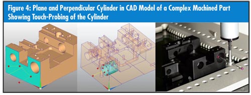

If we want to measure the perpendicularity of the cylindrical axis of one of these holes to the surface the hole is drilled into, a touch probe is the best tool for the job. As seen in figure 4, points on the plane can be probed, and a star probe can then collect points along the cylinder walls. Those sets of points are fit to a plane and cylinder, respectively, and their angular relationship is measured.
