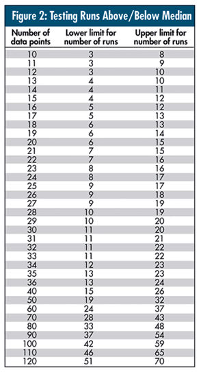

There is a third test used in conjunction with the trend and runs-of-length-eight tests. It is based on the total number of runs observed above and below the median in a data collection. A run is counted from the first data point until it is broken by crossing the median (points that are literally on the median are ignored for this analysis). From the graph, the 16 data points yielded only four runs total (of lengths 7, 7, 1, and 1)--two above and two below the median.
Looking in the left column of the table in figure 2, under “Number of data points,” at 16 and reading across: 5-12 runs are expected to occur if the variation is only random (common cause). Four is below the expected lower limit of five. Hence, with low risk, the conclusion is that the special cause intentionally imposed after the sixth observation most probably did create the desired effect.
Generally, a successful intervention will tend to create fewer than the expected number of runs. It is relatively rare to obtain more than the expected number of runs. In my experience, this usually indicates that two process inputs are being reflected by them being unintentionally sampled alternately.
I also encountered a situation where someone had fudged data by trying to make it look random--and did too good a job. There is such a thing as being “too random!”
So, unless one gets fewer than the number of runs, one must assume, based on the current data, that there is no evidence of process change. Ott’s, Schilling’s, and Neubauer’s book, Process Quality Control: Troubleshooting and Interpretation of Data, Fourth Edition (ASQ Quality Press, 2005), and Acheson J. Duncan’s classic, Quality Control and Industrial Statistics, Fifth Edition (Richard D. Irwin, 1986), discuss runs analysis extensively and contain more tables. My table uses p < 0.05.
