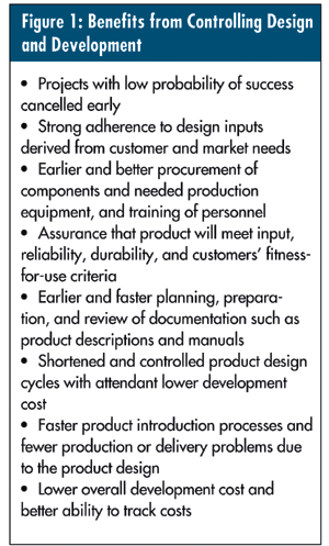

Because design and development processes often involve costly, time- sensitive activities, top managers should see opportunities to get their new products developed on time and within budget. That’s the major benefit of these controls: They promote orderly completion of innovative work. More specifically, see figure 1 for benefits attained by applying these controls.
