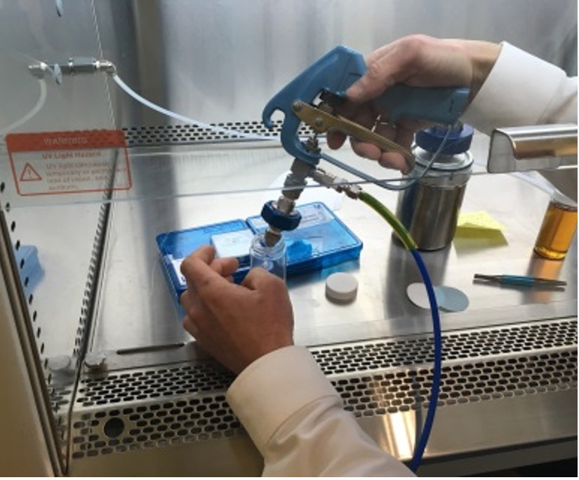

When extracting an oil sample, it is important to make sure the sample is not contaminated by external impurities. Some best practices:
• Use a vacuum to extract the oil
• Do not run it through a pump that might contaminate the oil
• Extract from the middle of the tank, as there might be a concentration of contamination in the bottom or corners of the tank

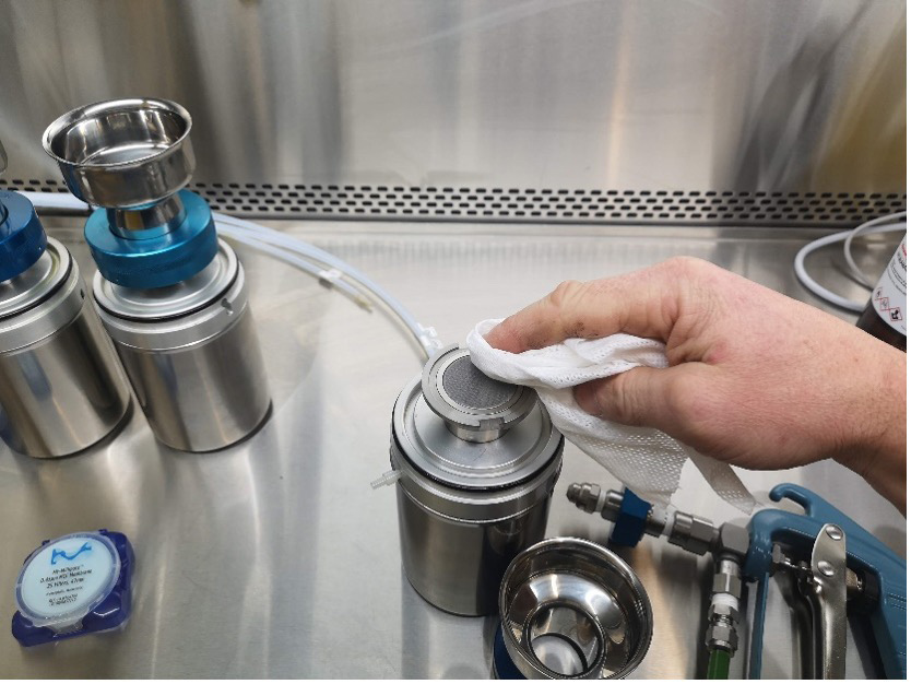

Here is an example of an oil sampling procedure that keeps cleanliness in mind:

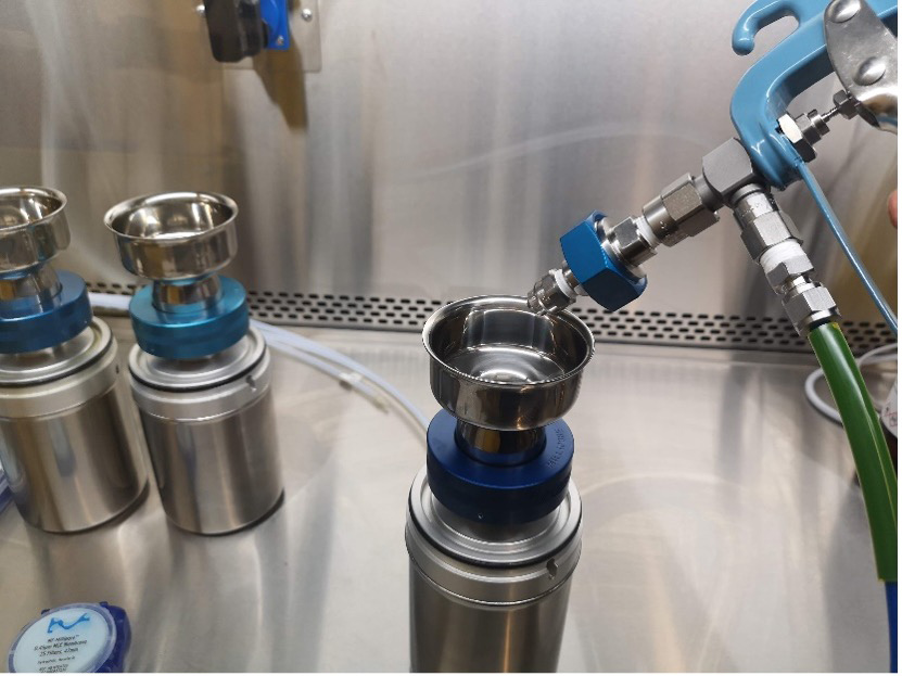

1. Wet the funnel with a solvent, such as heptane or clean petroleum, and wipe the funnel with a lint-free cloth. Next, wet the mesh with the solvent and wipe with a lint-free cloth.
2. Put the funnel in place and wash the inside of the funnel and mesh. Now the sampling equipment is clean and ready to use.

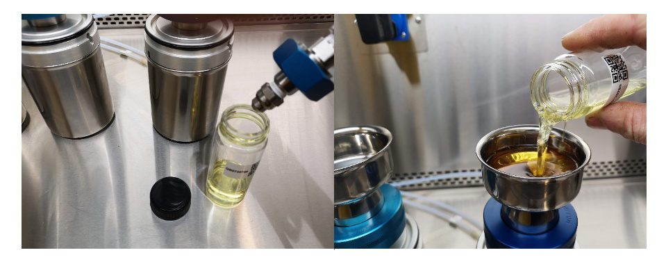

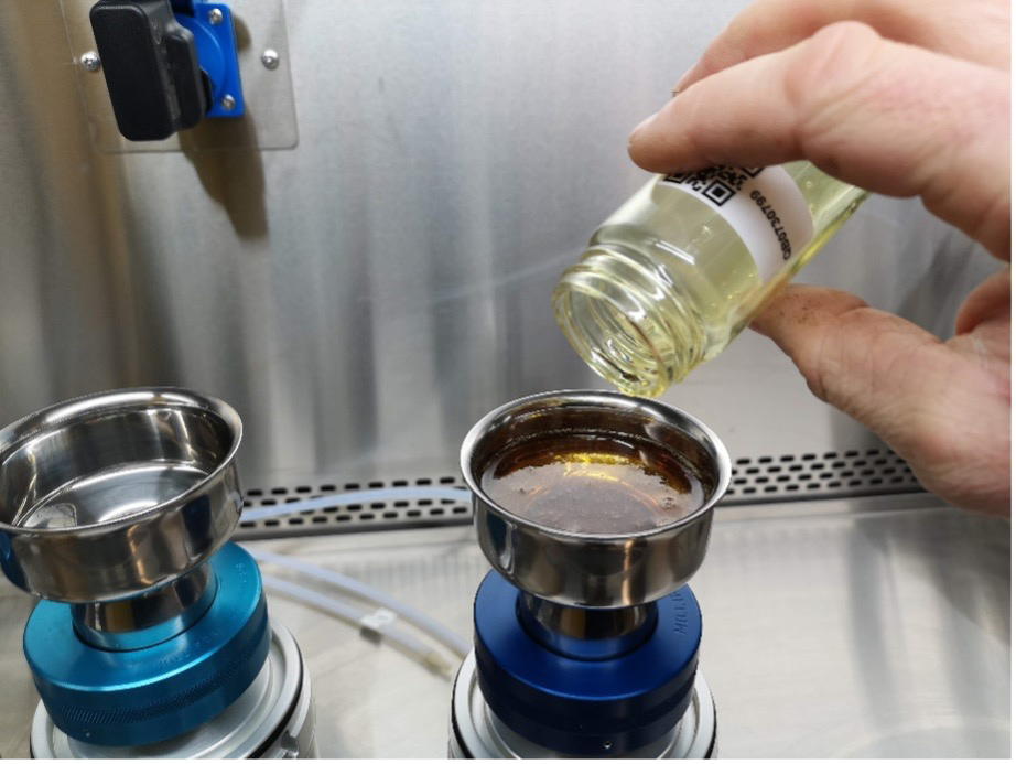

4. Pour the oil sample (about 2 ml to 100 ml, depending on the suspected particle contamination) into the funnel. Begin to create a vacuum inside the flask to draw the liquid through the filter.

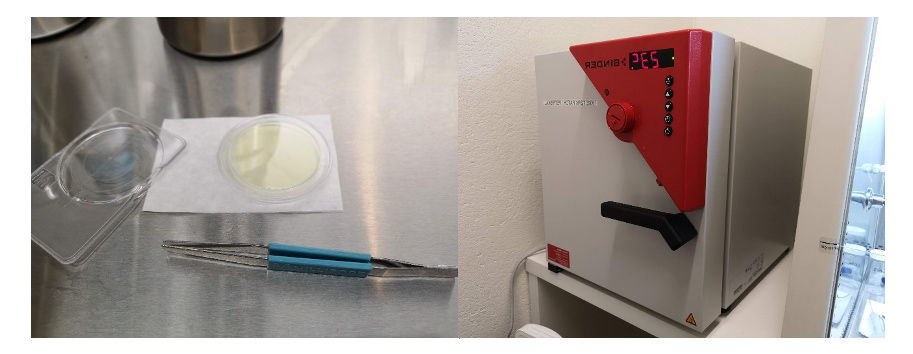

6. Remove the sample filter and dry it under a hood or in a drying oven. Place the sample filter in a Petri dish and mount the membrane on the filter holder.

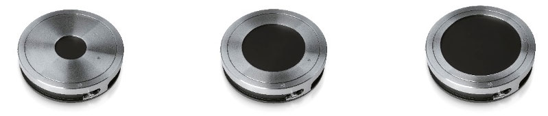

The Olympus CIX100 technical cleanliness inspection system offers dedicated sample holders to perform direct liquid filtration. These sample holders are available in 25 mm, 47 mm, and 55 mm diameters, as well as white or black backgrounds to suit the application.
Sample holders with a black background in diameters of 25 mm (left), 47 mm (middle), and 55 mm (right) are available for direct liquid filtration in a microscope-based cleanliness analysis.
If a solvent was used to filter the liquid, using sample holders with a black background is recommended because these are largely inert to solvents. To simplify the analysis, the software of the CIX100 system automatically loads the appropriate settings when the operator selects the sample type. Sample holders with a black background in diameters of 25 mm, 47 mm, and 55 mm are available for direct liquid filtration in a microscope-based cleanliness analysis.
