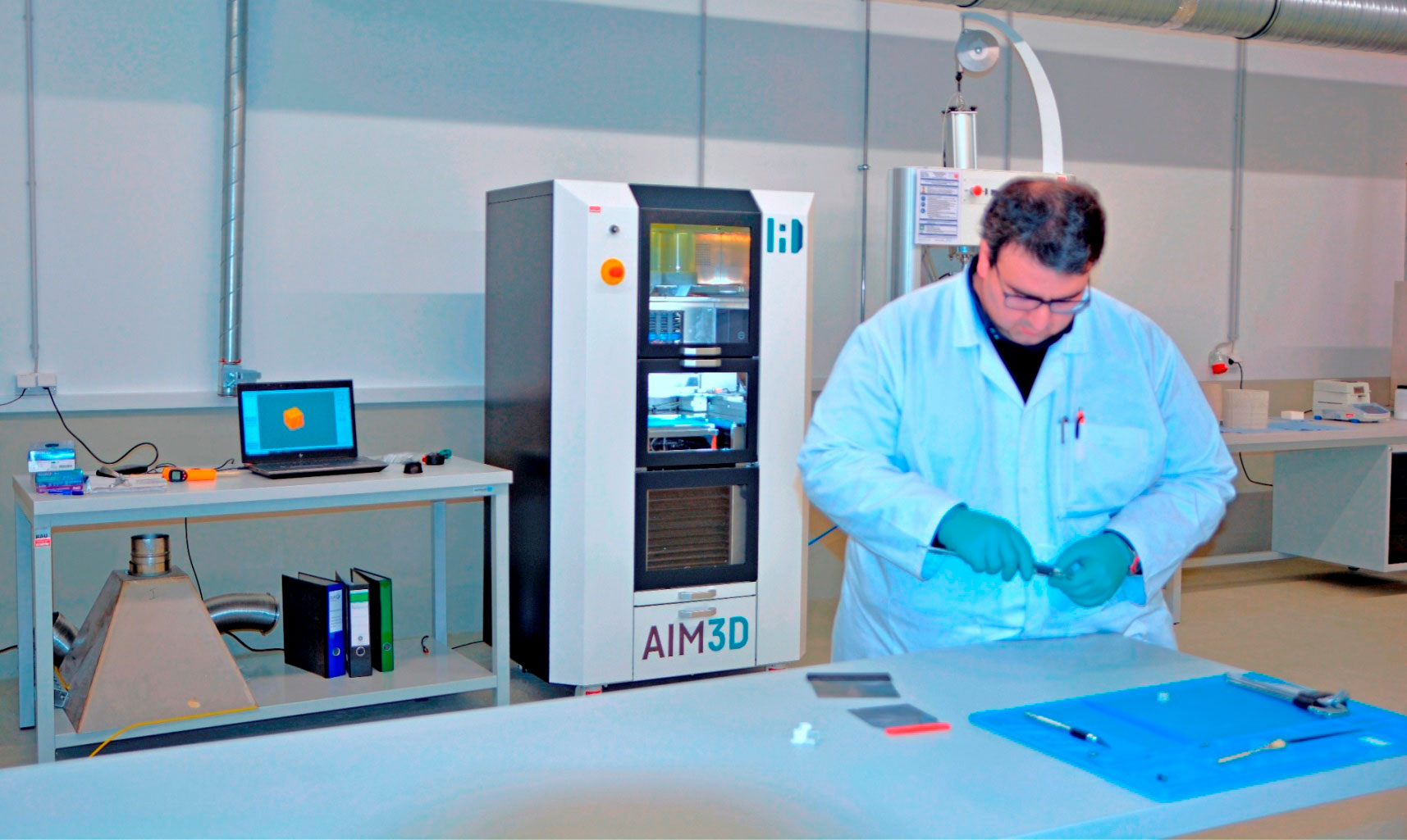

The composite extrusion modeling (CEM) process combines the metal injection-molding (MIM) process, which is already established worldwide, with process technologies from additive manufacturing.
This is based on both the fused deposition modeling (FDM) process and the selective laser melting (SLM) process, thus creating an optimal blend of conventional production methods and innovative additive manufacturing.
The result is a very simple process, based on inexpensive and widely available injection-molding pellets while offering the freedom of additive manufacturing with no need for molds. The CEM process not only significantly lowers material costs, but also drastically cuts machine costs. Common problems in metal manufacturing, such as residual stresses, are significantly reduced with the CEM process.
Fused granulate modeling (FGM) is an additive manufacturing process and is based on the widely used thermoplastic melt layer process (FDM/FFF).
The print head processes pellets into a thin melt thread and applies it to the build area. Thanks to the automatic generation of support material, more complex shapes can also be produced, enabling custom-made production or prototype production with injection-molding technology. In contrast to the common melt layer processes, such as fused filament fabrication (FFF), FGM does not use an elaborately produced filament but conventional series-production thermoplastic injection-molding pellets.
