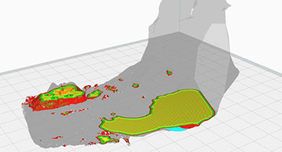

Symptom: “This print isn’t sticking to the bed properly. I think the plate needs a wash.”
Cause: Although the 3D model you obtained might appear to have a flat bottom, in fact it doesn’t. The slicer then dutifully creates a first layer that has only a very small portion on the bed, and the second layer is printed in the air. The print usually fails.
Solution: This is easily detected by using the GCODE preview as above. But if it is present, you must take the 3D model and do a quick “plane cut” to ensure the bottom is actually flat. In some cases the model does have a flat bottom, but it’s tipped slightly to have only the corner touching. In that case, use the slicer’s “put this face on the bottom” to rectify.

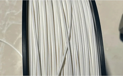

Symptom: “My print job air-printed again, but it had plenty of filament left!”
Cause: Unbeknownst to you, there was a single tangle in the filament. As the print proceeded, the extruder was able to pull a fair length of filament from the tangle. However, eventually the tangle became tight and the extruder started slipping, stopping material flow to the hot end.
The tangle was caused by a loose filament end somehow getting under one of the loops.
Solution: Be very, very aware of the filament end. Always keep it under control, in your hand or securely stuck in the filament notch/hole in your spool. If it’s ever loose, the coil will almost instantly spring back and form a tangle. If that happens, roll off a long length of filament manually and respool to get rid of the tangle.

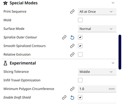

Symptoms: “Wait a moment, why is this print completely hollow?” “There’s something terribly wrong with the printer; the surface is all wobbly!”
Cause: Popular slicing software often has some very interesting experimental features, and it’s fun to try them. But after trying them out, you forgot to turn them off. Typical failures in this scenario include leaving the “Spiral” or “Vase” mode on, and printing your model with a single wall. Another failure is leaving “fuzzy skin” on, which generates that incredibly cool texture you wanted on yesterday’s print—but not on today’s.
Solution: When reviewing the slicing parameters, make sure you venture into the experimental section to ensure settings are correct. In fact, always review all of the slicer settings before committing to print.
