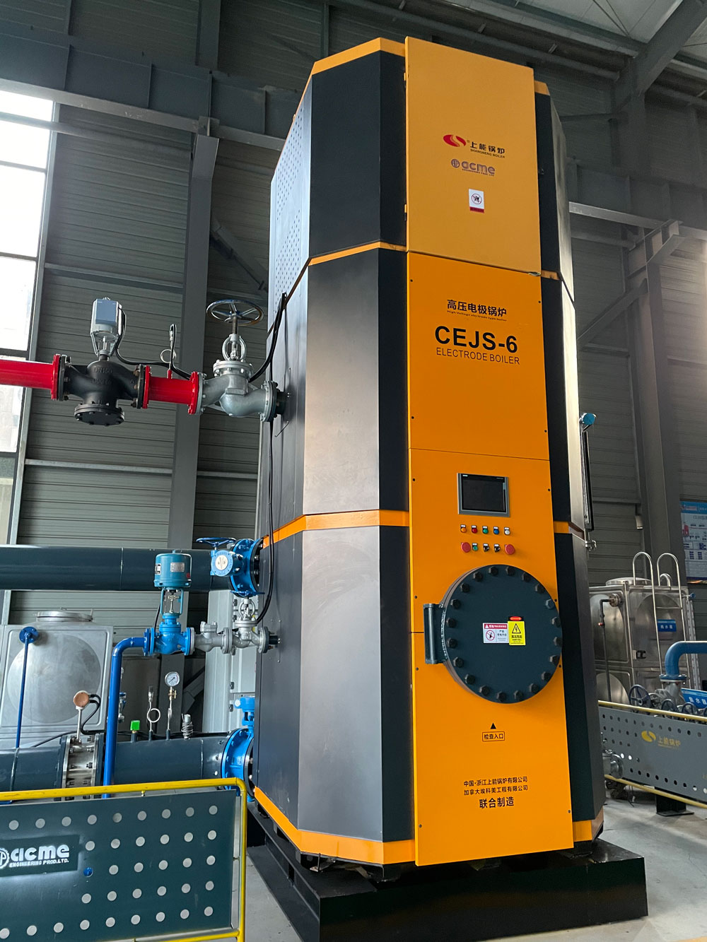

Presser explains that electric boilers use the conductive and resistive properties of water to carry electric current and generate steam. An AC current flows from an electrode of one phase to ground using the water as a conductor. Since chemicals in the water provide conductivity, the current flow generates heat directly in the water itself. The more current (amps) that flows, the more heat (BTUs) is generated, and the more steam produced.
As an example, in Acme’s CEJS High Voltage Electrode Steam Boiler, almost 100 percent of the electrical energy is converted into heat with no stack or heat-transfer losses. The electrodes of the jet-type electrode steam boiler are vertically mounted around the inside of the pressure vessel. This enables the unit to produce maximum amounts of steam in a minimum amount of floor space, with boiler capacity from 6 MW to 52 MW. Operating at existing distribution voltages, 4.16 kV to 25 kV with up to 99.9-percent efficiency, the boiler can produce up to 170,000 lb of steam per hour. With pressure ratings from 105 psig to 500 psig, the boilers are designed to ASME’s BPVC Section 1, and are certified, registered pressure vessels at the location of the boiler.
“With the jet-type electrode boilers, there are no combustion hazards because there are no flames, fumes, fuel lines, or storage tanks, which minimizes the risk of explosions and fires,” says Presser. In case of an electrical short, the breaker that protects the high-voltage circuit trips in a matter of milliseconds, protecting the boiler and the electrical network. There is no chance of electrical mishap or fire from the boiler.
Because the design doesn’t rely on combustion, it doesn’t create emissions that would endanger the operator or environment. In addition, the design eliminates many environmental issues associated with fuel-burning boilers, such as fuel fumes, fly ash, and large, obtrusive exhaust stacks.
This approach resolves safety issues related to potentially excessive heat accumulation with the system as well. Low-water protection is ensured because the absence of water prevents current from flowing and the electrode boiler from producing steam. Unlike conventional electric boilers or fossil-fuel boilers, nothing in the electrode boiler is at a higher temperature than the water itself. This prevents the risk of dangerous heat buildup in the boiler, electrodes, and other important components, even if scaling should occur, and thermal shock is eliminated.
“Electric boilers, and specifically the electrode units, are inherently the safest boiler design today,” explains Presser. “These units don’t need an operator because if anything goes wrong, the breaker trips, preventing further escalation of the issue.”
