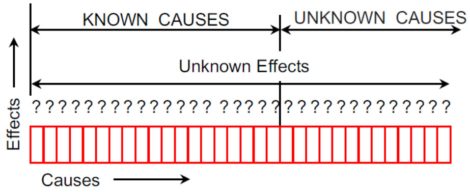

Any specific product characteristic will be the result of dozens, if not hundreds, of cause-and-effect relationships. These causes can be divided into two groups: those causes that we know well enough to name, and those causes that operate without our knowledge and that therefore remain unknown to us. Before we start production, the effects of all of these causes may well be unknown, resulting in a picture like figure 1.
Figure 1: Two categories of cause-and-effect relationships

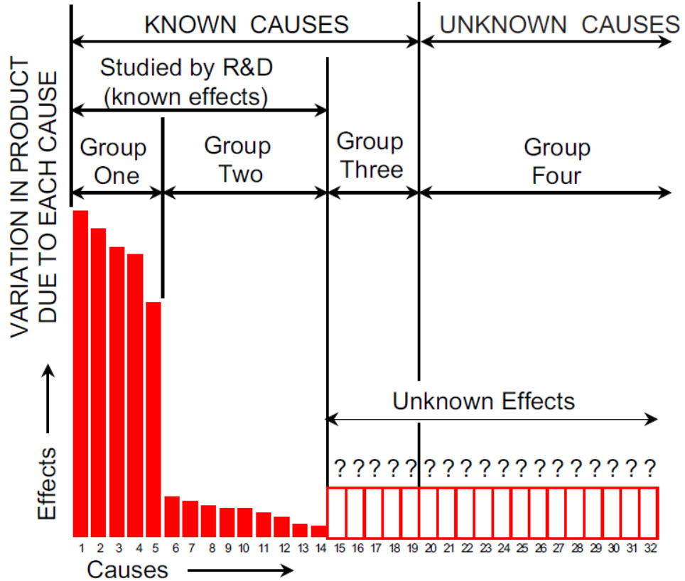

Typically R&D will study a subset of the known causes to determine their effects. These studied causes will be those that are thought to have pronounced effects upon the product characteristic. Once these effects are known, this set of studied causes can be organized into a Pareto diagram as shown in figure 2.
Figure 2: Pareto of known effects for the studied causes
Denote causes one through five as Group One causes. These causes have dominant effects and are the causes we will want to control during production. By holding these five causes constant, we will effectively remove their effects from the product stream. At the same time, the fixed values chosen for each of these five causes will collectively determine the process average.
Call causes six through 14 the Group Two causes. These causes have such small effects that we will not attempt to control them in production. (Typically these are those causes where the cost of control exceeds the benefit of control.)
Among the 14 causes studied, if no attempt to control the causes was made, the effects of the five causes in Group One would make up 85 percent of the variation in the product stream, while the remaining nine causes in Group Two would contribute 15 percent of the variation. So by controlling the Group One causes, we remove 85 percent of the variation due to the studied causes.
Group Three causes will be those known causes that were not studied by R&D. Generally, these are causes whose effects were thought to be minimal and were therefore considered not to be worth investigation. However, as noted in figure 2, these causes will actually have unknown effects.

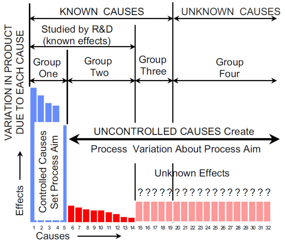

For convenience, let’s denote the collection of all of the unknown cause-and-effect relationships that affect our process without our knowledge as Group Four causes.
Figure 3: Process variation comes from all the uncontrolled causes.
Unfortunately, the variation in the product stream is not limited to the causes in Group Two alone. Causes in Groups Three and Four will also contribute to this variation. As causes in these three groups vary, they will each contribute incremental variation to the product characteristic, and all of these sources of variation will add up to result in the variation in the product stream. This is why the variation observed in production will generally exceed the variation predicted by R&D.

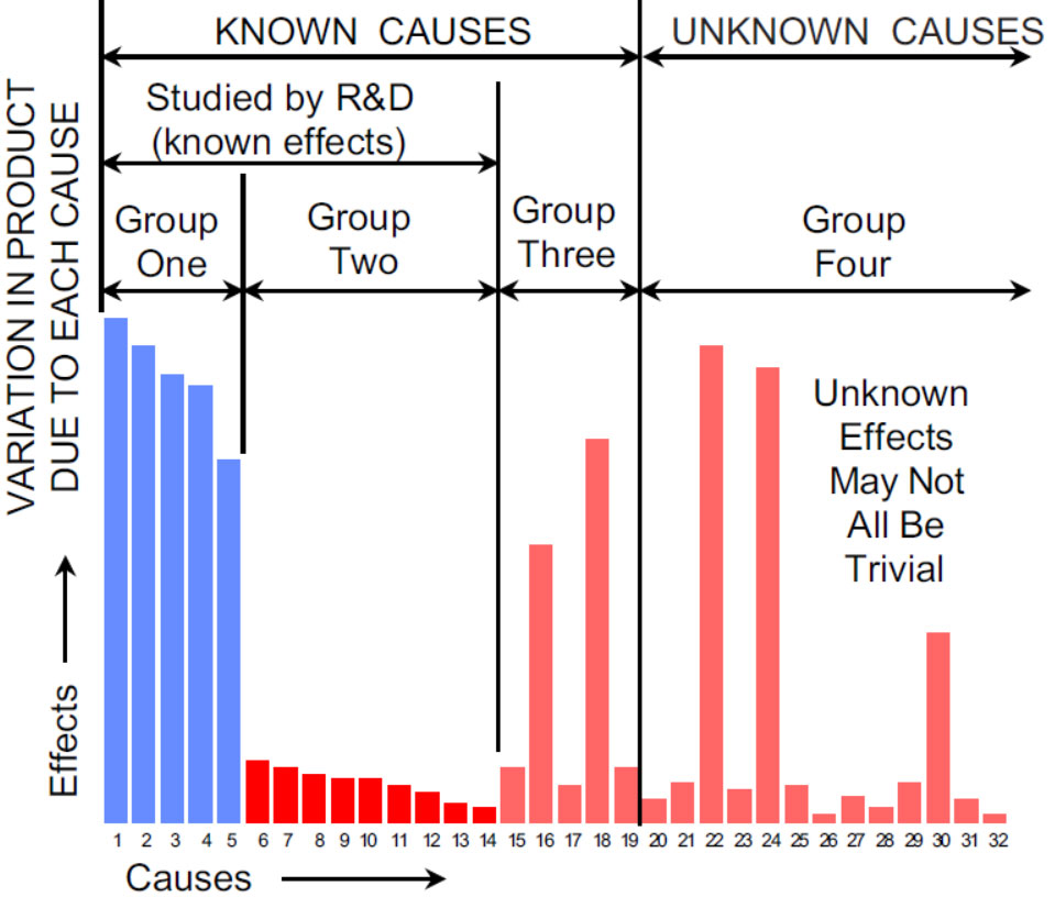

Finally, there is no guarantee that the unknown effects of the causes in Groups Three and Four will all be small. Furthermore, these effects can change over time. These changes can occur with wear and tear, with changes in personnel, with evolving operating techniques, and with changes in the supply of materials. When these changes occur, they can further complicate the question of process improvement.
Figure 4: Some uncontrolled causes may have dominant effects.
Thus, figures 3 and 4 define a framework against which we can evaluate different improvement approaches. They characterize what we know and what we do not know so that we can see how a particular approach deals with each element in the problem of process improvement.
From figure 3 we see that problems of setting the process aim will involve the choice of levels for causes in Group One. Problems of reducing the variation in the product stream will involve causes in the other three groups.

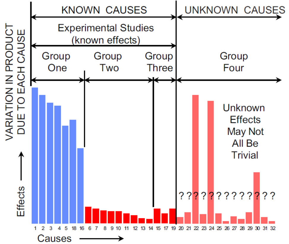

When experimental studies are used with causes from Groups Two or Three, the objective is to identify any causes that might have a dominant effect. When such causes are found, they can then be moved to Group One to remove their variation from the product stream. Of course, experiments with causes from Group Two will be looking for large effects where R&D originally found only small effects. And experiments that study causes from Group Three will be looking for large effects where no large effects were thought to exist. However, over time, due to wear and tear and other effects of entropy, causes that formerly had a small effect can evolve into causes with a large effect.
For this reason, experiments with causes in Groups Two and Three can sometimes be helpful. In figure 5, causes 18 and 16 were found to have dominant effects and were moved from Group Three to Group One. This reduced the average cost of production and use (ACP&U) for this process to 75 percent of what it was in figure 4.
Figure 5: What experimental studies may achieve
But what about causes in Group Four? Although we are not able to study unknown causes in an experiment, this does not mean that our experimental results are exempt from the effects of any unknown causes in Group Four. If a dominant cause from Group Four happens to change during the course of an experiment, it can wreck the analysis and ruin the experiment. (Most statisticians can tell you stories of what happened when some extraneous variable from outside the study messed up an experiment.)
So while experimental studies are essential in setting up a process, and while they allow us to review the effects of various process inputs, they face certain limitations in the problem of process improvement. Although experiments allow us to get definite answers to specific questions, they are of limited utility when we do not know what questions to ask.

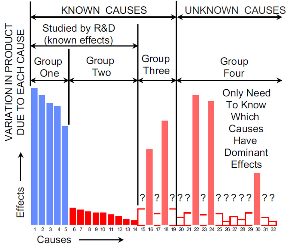

Experimental studies always start by identifying a set of causes to study. Observational approaches do not do this. Rather, they seek to learn about the process by using the existing data. Since existing data will generally be obtained while the causes in Group One are being held constant, observational approaches will tend to focus on the uncontrolled causes.
Figure 6: What we need to know
The idea behind an observational approach is that we really do not need to know the sizes of all of the effects in figure 6. Rather, we only need to know which uncontrolled causes have dominant effects (causes 16, 18, 22, 24, and 30 here). Once we know which causes have effects that are large enough to change the product stream, we know which causes need to be moved to Group One. And we can make this decision regarding these causes without actually quantifying the size of their effects. The following will explain the characteristics of the two basic types of observational studies.

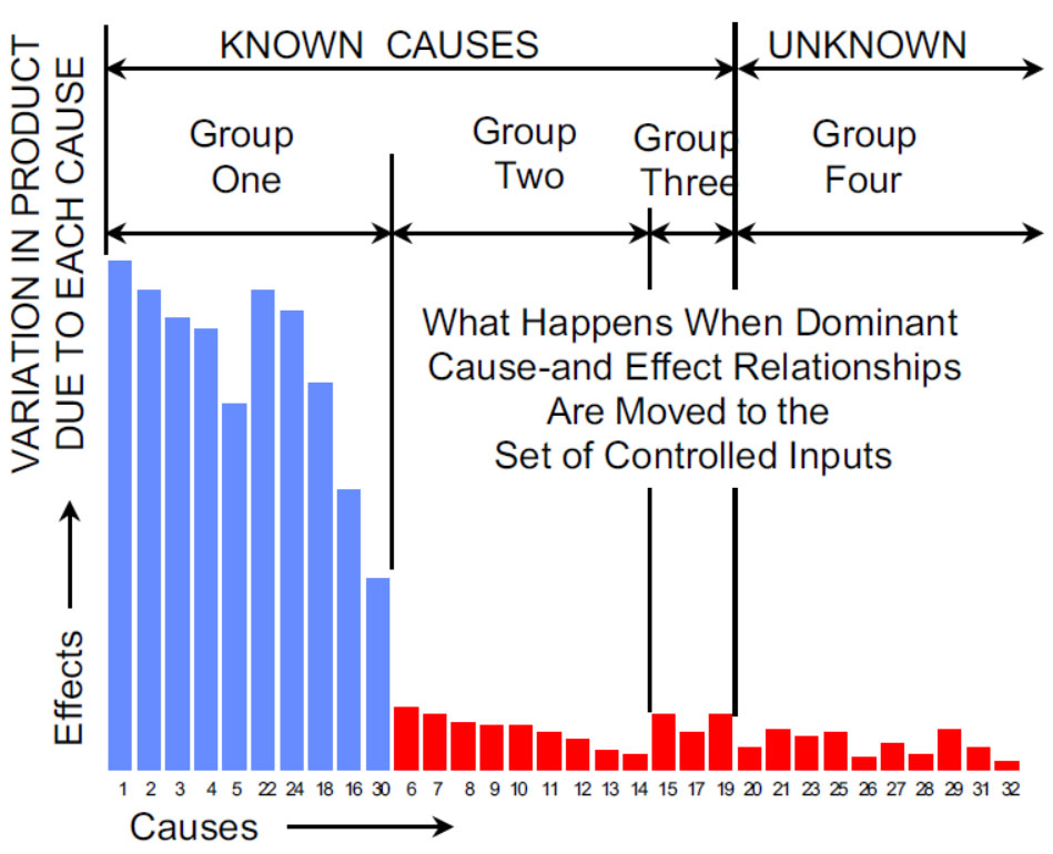

Process behavior charts have a proven track record as an observational approach to process improvement. They provide an operational definition of how to get the most out of any process. The running record of the product characteristic displays the actual process performance. The limits of the process behavior chart define the process potential—what the process is capable of achieving when it is operated on-target with minimum variance. By superimposing the process performance upon the process potential, a process behavior chart provides a way to judge how close a process is to operating at full potential. Moreover, it allows us to identify when a change has occurred in the process. And these changes are the key to identifying the unknown causes with dominant effects from Group Four.
Some critics who have not understood how process behavior charts work claim that they are “old hat.” But when it comes to mathematics, age does not invalidate a technique or change its applicability. Calculus is more than 300 years old, while the Pythagorean theorem is at least 2,500 years old. So although Walter Shewhart created the process behavior chart more than 90 years ago, the concept behind the chart is 2,200 years older. It was Aristotle who taught us that we should look at those points where the system changes in order to discover those causes that affect the system. And this is, in effect, what the process behavior chart allows us to do.
By identifying those points where the process changes, a process behavior chart allows us to detect causes with dominant effects that come from any of the four groups.
By waiting until the process displays a change in behavior, we also let the process prioritize the causes according to the size of their effects. In this way we discover those causes that have dominant effects without having to waste time and effort studying the many causes with trivial effects.
It is only with the approach of Shewhart and Aristotle that we can discover the unknown causes from Group Four that have dominant effects. It is both the known and unknown causes with dominant effects that create the signals found by process behavior charts. The ability to learn about causes in Group Four represents a major advantage of using process behavior charts. It allows us to learn about mistakes, bad practices, and dumb things that actually happen in production but would never be studied in any R&D program. And it allows us to discover in real time when things go wrong so they can be fixed in a timely manner. Thus, process behavior charts are both more general and more robust than the other approaches.
Figure 7: What can be achieved with process behavior charts
For the process shown in figure 7, the average cost of production and use (ACP&U) will be only 25 percent of the average cost of production and use for the process shown in figure 4. This fourfold increase in quality and productivity comes from moving causes 22, 24, 18, 16, and 30 into Group One.
