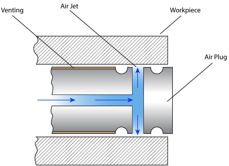

Air plug gauges are used for internal gauging, and air ring gauges are for external gauging. Usually, two jets face outward in an air plug gauge, and inward in an air ring gauge. They are symmetrically and precisely positioned on the diameter to balance the air flowing out. The amount of airflow under pressure depends on the particular readout system’s operating pressure and the size of the nozzles/jets.
The function of the air plug or air ring body is to guide the part and position the jets on the part’s diameter. The body of the air plug is constructed so it can be inserted into the lowest bore size (i.e., the inside diameter). An air ring gauge is made to fit the maximum diameter of a shaft (outside diameter), as per design tolerance. This varies as per the diameter of the part.
The gauge nozzles or jets are recessed into the gauge’s body for two reasons:
1. To provide protection so that during insertion the nozzles don’t touch the part under test and get damaged.
2. To direct and create a column of air that impinges onto the part surface normal to its curve. The more precise the positioning of the nozzle to the part’s curve, the more laminar the airflow, which ultimately decides the linearity of the indication.
Additionally, the recessed nozzle ensures that the jet of air has a self-cleaning effect on the gauging surface.

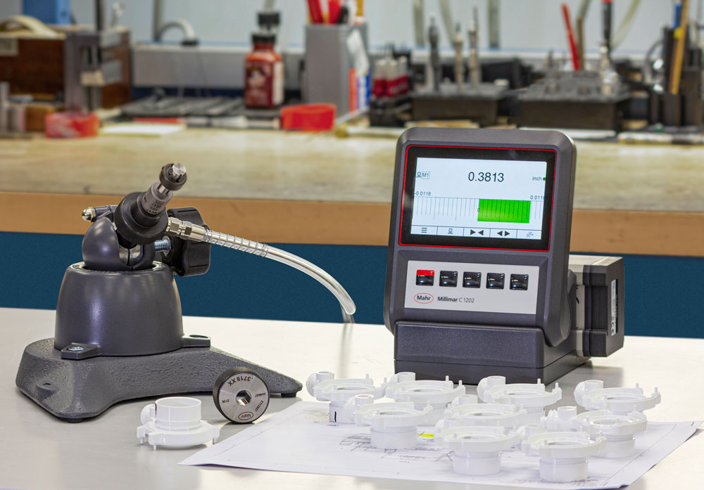

All air gauge readouts are pneumatic comparators regardless of the types of air gauging systems. They display a precise value of the part under inspection compared to a master part. They must be referenced or set to a master artifact (i.e., the setting master) of a known calibrated value. The displayed value is the size of the part compared to the master.
For example, a master with a known diameter of 0.9996 in. is measured with the air gauge, and the back pressure value is stored. An unknown part is then measured by the air gauge. The difference from that pressure reading compared to the master is determined to represent a value that is 0.0002 in. larger than the master. Thus, the display will show that the unknown part is 0.9998 in.
