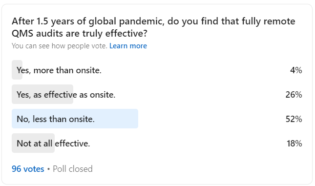

So, to open the discussion, I ran a poll on LinkedIn (a very scientific study, I know) that ran for one week that simply asked the question: “After 1.5 years of global pandemic, do you find that fully remote QMS audits are truly effective?” as well as prompting the respondents to comment with their experiences, techniques, perceptions, and thoughts for the future. Respondents were given the following four options in the poll: 1) Yes, more [effective] than onsite, 2) Yes, as effective as onsite, 3) No, less [effective] than onsite, and 4) Not at all effective. While there were only 96 respondents, the results of the poll were not all that surprising.
Most respondents, 52 percent, felt that remote audits were less effective than onsite audits, and after that, respondents became a bit more divided, with 18 percent taking this a step further and saying that they are not effective at all, and 26 percent believing remote audits that are currently being conducted are as effective as their onsite counterparts. Only 4 percent felt that remote audits were currently more effective.
Although the percentage of respondents saying that remote audits are currently as effective is a bit higher than expected, the data collected certainly suggest that there are some gaps to fill to make remote audits as effective as they should be, as well as effective as they will need to be as we potentially move to a more remote way of working.

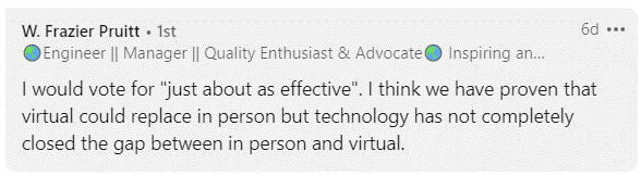

One respondent who had commented that he believed remote audits were “just about as effective” was asked what he thought would be needed to help close the gap so they could be as or more effective.
He states: “As strange as it sounds, the next-largest gap was connectivity throughout the plant. We had trouble running live video communication in many parts of operations. To add to the trouble, the noise made it difficult to hear, and it was impossible for the guide to hear. Some elaborate technology setup could help, but it also needs to be simple and reliable.”

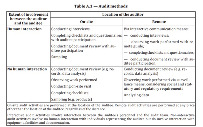

The third occurrence is in a note in Table A.1, which is a matrix outlining audit methods based on auditor location with these quadrants: onsite with human interaction, onsite with no human interaction, remote with human interaction, and remote with no human interaction, with the fourth in the succeeding paragraphs qualifying feasibility of remote audit activity.
For most of the respondents, it appears that most remote audits being performed are either remote with human interaction or a combination of remote with and without human interaction. The matrix gives several general methods for collecting information such as conducting interviews, observing work with a remote guide, completing checklists and questionnaires, and conducting document review with or without auditee participation, but it’s otherwise not a source of guidance on how to do so effectively.
The fourth occurrence exists in the statement, “The feasibility of remote audit activities can depend on several factors (e.g., the level of risk to achieving the audit objectives, the level of confidence between auditor and auditee’s personnel and regulatory requirements).” It goes on to say, “...it should be ensured that the use of remote... audit methods is suitable and balanced, in order to ensure satisfactory achievement of audit program objectives.” Similarly, this only restates the need to ensure that methods are used and resources determined and employed that ensure that audit objectives are met, but provides no other information on how to do so.
Image above from ISO 19011:2018 used with Fair Use Copyright for the purpose of education and commentary
