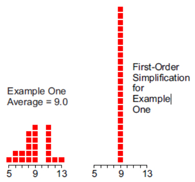

When we compute an average we are creating a first-order simplification of the data. We are reducing them down to one characteristic. The average is that single value where we could place all of the data without changing the location of the data set as a whole. Thus, the average may be thought of as the balance point for the data. Of course, the data are not all equal to the average, and we do not usually draw a graph with all the data at the average, but for the purposes of describing our data, the average provides a first-order simplification of the data.
Our first example will consist of 24 values with an average of 9.000.
{ 5, 6, 6, 7, 7, 8, 8, 8, 8, 8, 9, 9,
9, 9, 9, 9, 11, 11, 11, 11, 11, 11, 12, 13 }
Figure 1: The average as a first-order simplification for example one
As may be seen in figure 1, the location alone tells us nothing about how the data are spread out around the balance point.

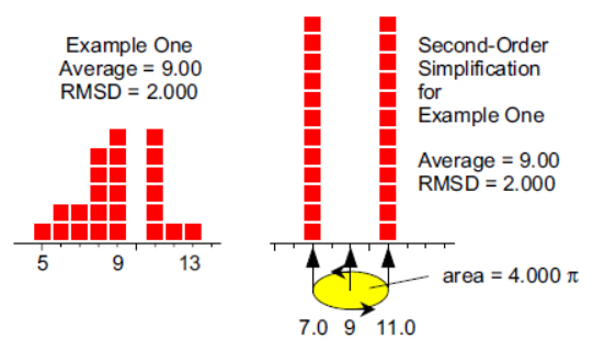

After the average, the second descriptive statistic is generally the standard deviation. Students are taught that this value defines dispersion, but how this works is seldom explained. Here, because we are interested in description rather than the estimation of an unknown parameter, we shall work with the “standard deviation” that is divided by [n] rather than [n-1]. The common name for this statistic is the root mean square deviation (RMSD).
Example one has an RMSD of 2.000 units. The “variance” statistic we shall use is the mean square deviation (MSD) which is 4.000 square units.
If we construct a second histogram with 12 values at [average – RMSD] = 7.000 and 12 values at [average + RMSD] = 11.000, this second histogram will also have an average of 9.0 and a RMSD of 2.000. Thus, the two histograms in figure 2 are equivalent in terms of location and dispersion. The histogram on the right is the second-order simplification for example one.
Figure 2: The second-order simplification for example one
If we spin the second-order simplification about its balance point we would inscribe a circle on the x-plane with area equal to 4.000 times pi. The MSD for both of the histograms in figure 2 is 4.000 square units, and now you see why the variance is always expressed as an area.
Thus, the variance for a data set or a probability model is a property of the second-order simplification of that data set or probability model. When we spin the second-order simplification about the average, the mean square deviation is the area of the inscribed circle divided by pi. Those familiar with physics may recognize the MSD as the rotational inertia of the histogram.
The square root of rotational inertia divided by mass is the radius of gyration. In probability theory the mass is always equal to 1.00, so this means that the RMSD is the radius of gyration for the histogram.
Since, like gravity, you cannot cheat on rotational inertia, we can use the properties of rotational inertia to tell us more about the histogram of the data.
So the second-order simplification preserves both the balance point and the rotational inertia of the original histogram. It also defines regions for the original histogram. The region between the two spikes (from 7 to 11 in figure 2) defines the central portion of the histogram. Points outside the central portion are said to be in the tails of the histogram.

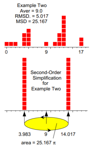

Our second example will consist of 24 values with an average of 9.00 and an RMSD of 5.017.
{ 0, 1, 2, 4, 4, 4, 5, 5, 5, 5, 9, 11,
12, 12, 12, 13, 13, 13, 13, 13, 13, 13, 17, 17 }
Figure 3: Second-order simplification for example two
Thus, the variance (MSD) directly measures the rotational inertia of your data set, and the standard deviation (RMSD) gives the radius of gyration for the data about the average. The central portion of the histogram for example two extends from 4 to 14 and five values are found in the tails of the histogram.

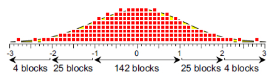

Our first digital probability model will be based on the standard normal distribution. While the standard normal uses a continuous variable, our digital model will use 200 building blocks, each of which is 0.10 standard deviations wide.
Figure 4: A digital standard normal model
Due to the roundoff inherent in using the building blocks, our digital model is not as smooth as the standard normal distribution shown in the background. However, when using 200 blocks, this is as close as we can get to the continuous probability model. The block size of 0.10 standard deviations restricts where the blocks may be placed. Each of the blocks is centered as close as possible to the z-score for the median of each interval containing 0.005 of the area under the standard normal distribution.

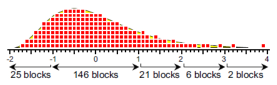

A standardized 8-degree-of-freedom chi-square distribution is shown by the smooth curve in figure 5. In the manner described in the appendix, using 200 blocks with a measurement increment of 0.1, we can find the digital version of this probability model shown in figure 5. Each block is centered as close as possible to the x-value for the median of each 0.005 of area under the standardized 8-degree-of-freedom chi-square distribution.
Figure 5: A digital standardized 8 d.f. chi-square model

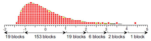

The standardized 4-degree-of-freedom chi-square distribution is shown in figure 6. Using 200 blocks with a measurement increment of 0.1 we can find the digital version of this probability model shown in figure 6. Each block is centered as close as possible to the x-value for the median of each 0.005 of area under the standardized 4-degree-of-freedom chi-square distribution.
Figure 6: A digital standardized 4 d.f. chi-square model

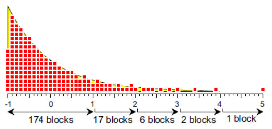

A standardized exponential distribution is shown by the smooth curve in figure 7. Using 200 blocks with a measurement increment of 0.1 we can find the digital version of this probability model shown in figure 7. Each block is centered as close as possible to the x-value for the median of each 0.005 of area under the standardized exponential distribution.
Figure 7: A digital standardized exponential model

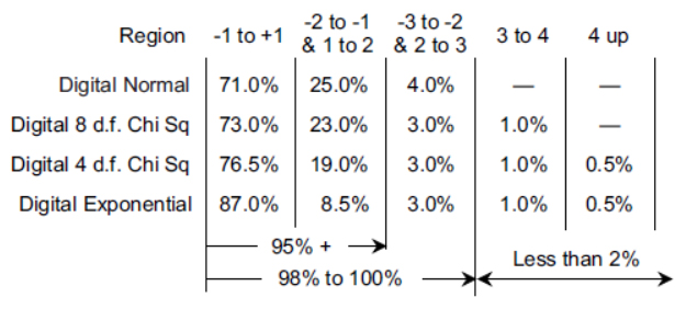

Even though these models have different shapes, they all have a mean of zero and a variance of one. As the upper tail gets elongated we see two things happening in the digital models. In order to maintain a variance of one we find an increasing number of blocks falling closer to the average. And in order to keep the average at zero we see the bulk of the blocks shifting over to the left side to balance the elongated tail on the right.
These two shifts result in an increasing number of blocks in the central portion of the model as the skewness of the model increases. This may be seen in the first column of figure 8. This increase in the central portion is the unavoidable consequence of having a few blocks further out in the extreme tail of the model. Balance and rotational inertia have to be preserved. Each point that gets moved out into the extreme tail requires that many more points get shifted closer to the average to maintain the average at zero and the MSD at 1.00.
Figure 8: Percentages of blocks in regions of the digital models
The second column of figure 8 summarizes the number of blocks found in the intervals from –2.0 to –1.1 and from 1.1 to 2.0. These intervals contain those blocks in the tails that are less than or equal to two standard deviations away from the average. As the skewness of the model increases the percentage of blocks in these intervals drop. This region is the primary source for the increased numbers of blocks in the central regions.
As a result, when we combine the first two columns we see that 95 percent to 96 percent of the blocks are found within two standard deviations of the average regardless of the skewness of the model. This characteristic of all mound-shaped probability models is a consequence of rotational inertia.
Rotational inertia requires at least 95 percent of the area to fall within two standard deviations of the mean for unimodal probability distributions having at least one infinite tail.
Another surprising characteristic of all mound-shaped probability models is found when we combine the first three columns in figure 8. Regardless of skewness, at least 98 percent of the area will fall within three standard deviations of the average.
If our probability models are going to have at least 98 percent of their area within three standard deviations of the mean, then there will be at most 2 percent of the area in the extreme outer tails. As the skewness increases the tails do not get heavier, they simply become more attenuated. Approximately 99 percent of the area will remain within three standard deviations of the average as the extreme tails stretch the last 1 percent or 2 percent out ever more thinly. (For more rigorous treatments of this topic see “Properties of Probability Models,” Part 1, Part 2, and Part 3” Quality Digest, August 3, September 1, and October 5, 2015.)
