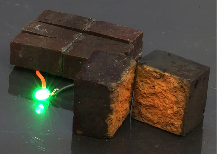

Chemically altering the red in ordinary bricks to become a nanofibrous plastic turns bricks into supercapacitors capable of storing enough electricity to power LED lights. Credit: Julio M. D'Arcy, CC BY-ND
A few pieces of PEDOT-coated brick are able to power an LED. Based on our calculations, approximately 60 regular-sized bricks would be able to power emergency lighting for 50 minutes, and they would take 13 minutes to recharge. One of the surprising results of our research is that the supercapacitor brick wall can be recharged 10,000 times, which is on par with more traditional PEDOT supercapacitors. We have published our results in the journal Nature Communications.
