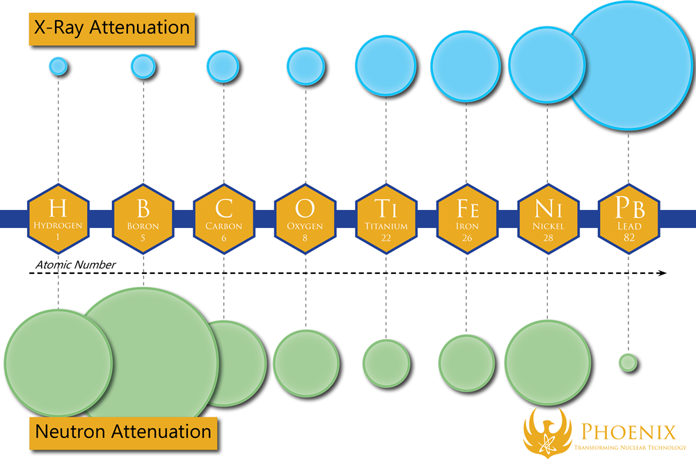

Instead of the X-rays commonly used for industrial radiography and computed tomography, neutron radiography relies on neutron radiation, which has altogether different transmission properties. Although an X-ray’s ability to pass through a material varies linearly with the material’s density—with dense materials such as lead being excellent X-ray absorbers and lighter materials often all but invisible to it—neutrons work differently. While the science behind how neutrons interact with matter is complicated, neutrons tend to pass through some dense materials such as metals more easily than lighter materials such as plastics.
N-ray is not simply the inverse of X-ray, although at first glance it might seem so. While X-rays are transmitted very linearly with decreasing density, neutrons are more random in their behavior. If you take two elements in close proximity on the periodic table—for example, silver and cadmium—they will appear to be nearly identical when seen in an X-ray image because they are of such similar density. If you were to take a neutron image of the two elements, however, they would look completely different, and it would be easy to tell which was which. This phenomenon occurs for many other elements such as hydrogen, lithium, boron, cadmium, and gadolinium, among others. Neutrons, to put things simply, are complicated and strange things.

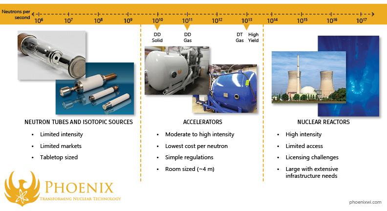

It is currently underutilized, though, due to lack of access to powerful neutron sources. Since the 1950s, only a handful of nuclear fission reactors intended for research purposes have had N-ray capabilities. However, advances in accelerator-based neutron generators, which rely on nuclear fusion and provide a high neutron output without some of the disadvantages associated with fission reactors, are shifting this paradigm. Phoenix LLC has recently opened a first-of-its-kind neutron imaging center which does not rely on a nuclear fission reactor as a neutron source.

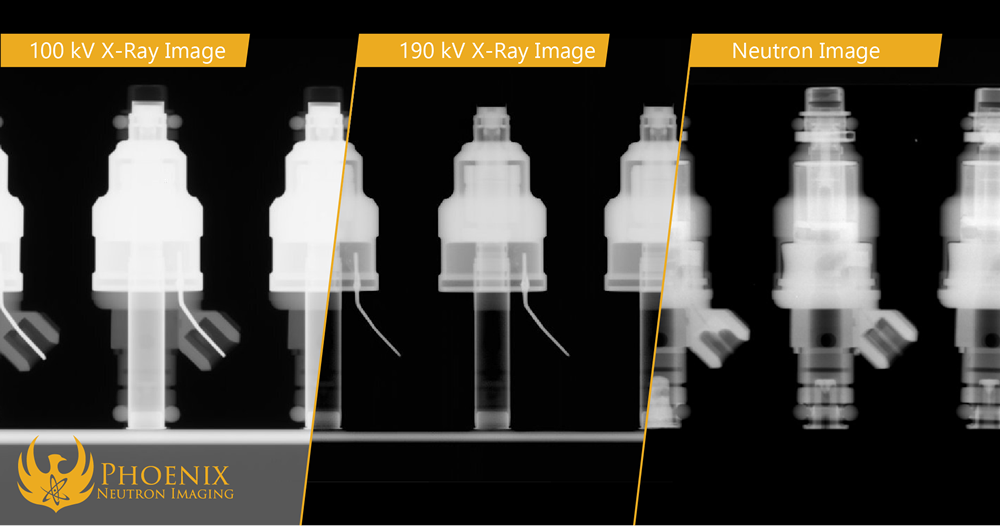

A Category I thermal neutron image, which meets the highest measurable threshold for quality according to ASTM standards, can provide just as much insight into a part as a 3D model produced via CT, or possibly more, depending on the part’s makeup. For example, light elements encased in metallic housings are very difficult to observe with industrial X-ray capabilities. At the higher energies required to penetrate the metallic housings, the X-rays will breeze past the light materials within, leaving the inside features completely invisible. For neutrons, however, the opposite can be true, as neutrons easily pass through many dense materials without penetrating other lighter materials. Therefore, in certain circumstances, a single 2D neutron can provide more accurate information than a CT. It all depends on what you’re inspecting and looking for.

When considering whether N-ray or CT is more efficient and cost-effective, the matter gets even more complex, taking into account factors such as safety and the footprint of the system. Like X-rays, neutrons are a form of ionizing radiation, and therefore they can cause harm to living tissue. They are just about as dangerous as high-energy X-radiation, but because of their special transmission properties, neutron sources require not only roughly similar degrees of shielding to X-ray setups, but also special shielding. The typical lead door you’d find in an X-ray vault would do next to nothing to stop neutrons; they would pass through it as though it was barely there. For this reason, select materials that have high neutron-absorption cross sections, mainly hydrogen and boron, are used in sheets of plastic and high-density polyethylene to make shields against neutrons. This is a very common and effective method for radiation shielding.
Most neutron sources will require their own room due to the radiation present. At most facilities, the neutron-producing area has one room to itself, and the neutrons are transmitted to a second room that contains the radiographic instrumentation. Some small sources can be located in just one room or even out in the open environment so long as nobody is too close to them. Therefore, the footprint of an N-ray system compared to a CT system will vary depending on the size and strength of the neutron source. The question of footprint is especially relevant if you are considering installing a neutron generator onsite for convenient access to neutron imaging (which eliminates issues such as burdensome shipping logistics and some overhead costs), but not particularly relevant if you intend on relying on third-party neutron imaging vendors.

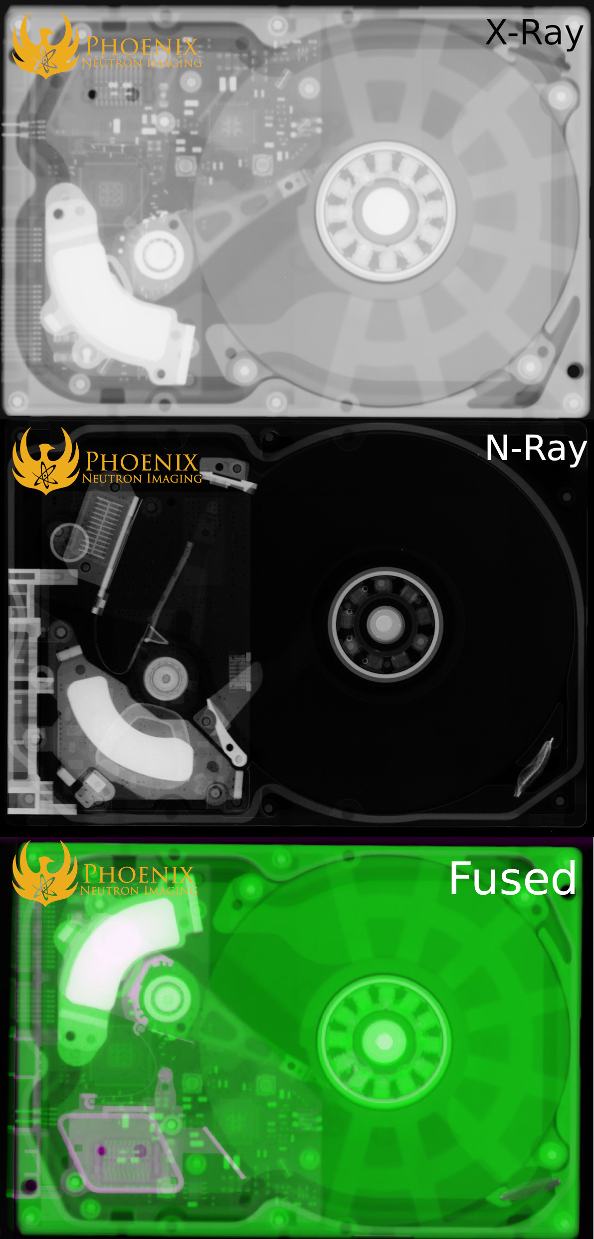

Because neutron-based inspection techniques are becoming more accessible, we’re paving the way for new and advanced imaging techniques, such as combining the data from planar N-ray and X-ray into a hybrid image that shows both perspectives at once. It is also possible to perform computed tomography using neutrons instead of X-rays to produce 3D neutron images more directly analogous to the output of X-ray CT imaging.
