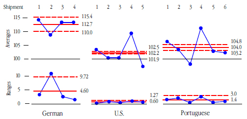

A plant had three suppliers for a piece of wire. When a shipment arrived they collected a sample of five pieces and measured their lengths. These five values were subgrouped together and placed on an average and range chart. The charts for each of the three suppliers, drawn to the same vertical scale, are shown in figure 1.
Figure 1: Average and range charts for wire lengths

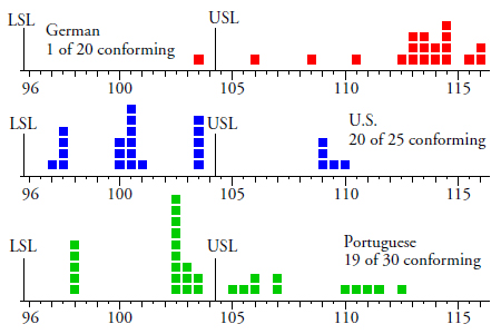

The specification for this piece of wire was 100 mm ± 4 mm. These specifications are shown on the histograms for these three suppliers in figure 2.
Figure 2: Histograms for wire lengths
Only one of the 20 pieces from the German supplier was within the specifications! Moreover, the points outside the limits on the average and range chart for the German supplier show inconsistency both between the shipments and within the shipments. Based on this performance, the German supplier was dropped.
The range chart for the U.S. supplier shows great consistency within each shipment, but the average chart shows completely different average lengths between the shipments. The histogram for the U.S. supplier reinforces this interpretation by showing four separate clusters. The first cluster on the right is shipment 5. The next cluster is for shipments 2 and 3. Next comes shipment 1, followed by nonconforming shipment 4. So while the U.S. supplier has great consistency within each shipment, they have a real problem with setting the process aim.
This story repeats itself with the Portuguese supplier. They have good consistency within each shipment but real differences from shipment to shipment. Based on the charts above, the U.S. supplier and Portuguese supplier were told that their problem was setting up each production run on target.

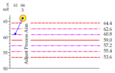

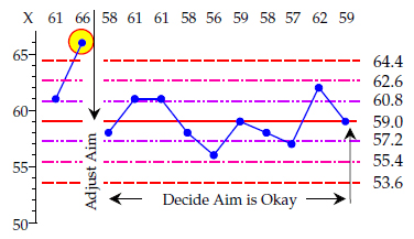

Product 16F had a target value of 59.0 units. Process behavior charts provided a Sigma(X) value of 1.80 for this product. With these values the three-sigma limits were 53.6 to 64.4. The two-sigma lines were 55.4 to 62.6. And the one-sigma lines were 57.2 to 60.8.
As the production of Product 16F began the first observation was 61. By itself this value did not indicate any problem with the process aim, so no action was taken. As soon as it was reasonable, a second observation was taken. This value was 66, which signaled the need to adjust the process aim. The average of 61 and 66 is 63.5, so they estimated that the process average needed to be reduced about 4 units. The process aim was adjusted accordingly.
Figure 3: Target-centered X chart
The next observed value was 58. No action needed. In fact the next nine values were 61, 61, 58, 56, 59, 58, 57, 62, and 59. As shown in figure 4 this sequence of 10 values contained no signals that the process average was off target. This was taken as an indication that the process average was reasonably close to the target.
Figure 4: Target-centered X chart
At this point, as will be explained below, there was better than a 91-percent chance that the process average was within ±1 Sigma(X) of the target value. So they shifted from the aim-setting mode to the process monitoring mode.

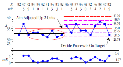

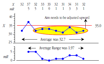

A new process is being set up. The target value for the product is 35. After the initial warm-up period observations are obtained every 2 minutes. The first 10 values are 32, 37, 32, 33, 33, 32, 31, 34, 31, and 32. Figure 5 shows the beginning of the target-centered XmR chart.
Figure 5: Initial portion of target-centered XmR chart
The run of eight successive values below the target value of 35 is a signal that the process is not centered on the target. Since the average for these first 10 values was 32.7 the aim was adjusted upward by what was thought to amount to two units.
The average moving range in figure 5 is 1.97. Dividing by d2 = 1.128 we get an estimate of Sigma(X) of 1.75. Using this value we get target-centered three-sigma limits of 29.75 and 40.25; two-sigma lines of 31.5 and 38.5; and one-sigma lines of 33.25 and 36.75. The upper range limit is 6.4.
These lines could be used to evaluate the first 10 observations, but since we already had a signal that this process was off target we simply use these lines to evaluate additional observations from the process as shown in figure 6.

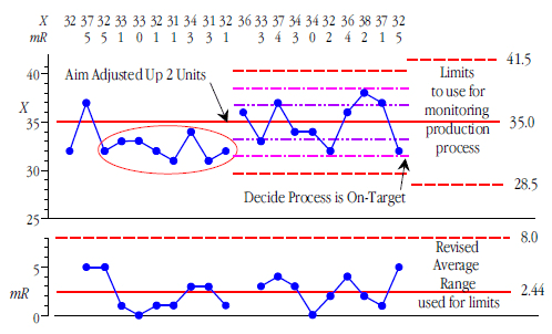

With 18 moving ranges now available we recompute the average moving range and target-centered three-sigma limits. Here the average moving range is 2.44, resulting in target-centered three-sigma limits of 28.5 to 41.5. The upper range limit becomes 8.0. The revised estimate of Sigma(X) is now 2.16 units. These revised limits are used for monitoring the process.
In this example the process average was approximately one Sigma(X) below the target to start with, and the target-centered XmR chart detected this even before we computed any limits.

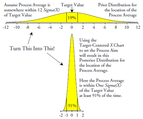

So, when we have 10 successive values on the target-centered XmR chart with no evidence of being off target after using all four of the Western Electric zone tests, what can we say about the process average? When we decide to cease to adjust the process aim, how close to the target is the process average? Figure 8 shows how the target-centered XmR chart works in practice.
Assuming that the process average is initially found to be within 12 Sigma(X) on either side of the target, with the more remote values being less likely, we end up with a prior distribution like that shown at the top of figure 8.
Figure 8: How the target-centered X chart works

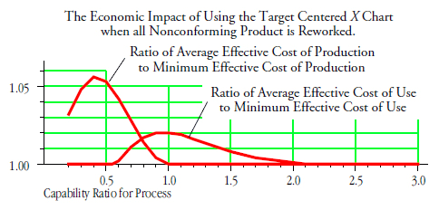

Figure 10: Economic impact with reworked product
So, when all nonconforming product can be reworked, the use of the target-centered XmR chart will get the average effective cost of production within 5.6 percent of the minimum possible effective cost of production regardless of the capability ratio for the process.

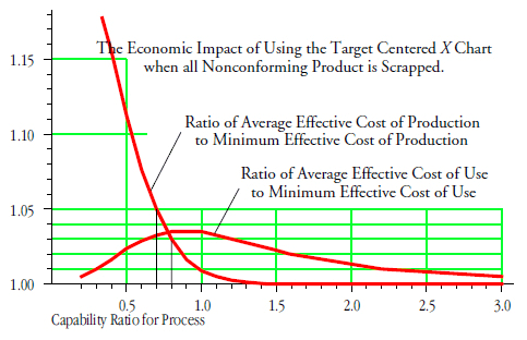

Figure 11: Economic impact with scrapped product
However, at the other extreme, when all nonconforming product is scrapped, the posterior distribution in figure 8 will result in an average effective cost of production that is within 5 percent of the minimum possible only when the capability ratio exceeds 0.70. To get the average effective cost of production within 3 percent of the minimum you will need to have a capability ratio of 0.80 or greater.

The posterior distribution for the average-to-target distance given at the bottom of figure 8 is the distribution that gives the answers we want to know. It gives the probabilities that a state of nature exists (the process is on target) given a specific observed outcome (the X chart shows no evidence that we are off target after collecting 10 values). Thus, the posterior distribution tells us what we need to know in order to interpret a specific observed outcome.
Probability theory gives us conditional distributions. These are the opposite of the above since they give us the probability of a specific outcome (the X chart shows no evidence that we are off target after collecting 10 values) given that a certain state of nature exists (the average-to-target distance takes on a specific value). Here the conditional distribution comes from the tables of the power function for an XmR chart in reference [1].
To turn a conditional distribution around to obtain a posterior distribution we have to use a prior distribution for the average-to-target distances. A prior distribution assigns a probability to each value for the average-to-target distances (prior to the process aim being adjusted).
By using the prior distribution with the conditional distribution according to the laws of probability theory (Bayes’ theorem) we can obtain the posterior distribution, and it is the posterior distribution that answers the important question of what is the probability of a state of nature given a specific observed outcome.
The prior distribution shown in figure 8 is sufficiently conservative to give reasonably stable results for the posterior distribution. For example, using a prior that allows the average-to-target distance to range between ±6 Sigma(X) would be only half as wide as the one in figure 8. Yet with this less conservative prior the posterior probability that the average-to-target distance is less than 1.0 Sigma(X) would only be 92 percent vs. the 91 percent found with the more conservative prior. So, by using a sufficiently conservative prior distribution we can usually obtain a reasonably stable posterior distribution that will provide a way to interpret our observed outcomes.
