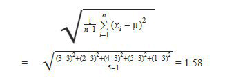

The standard deviation provides a measure of the variation or dispersion for a set of values. Suppose you want to measure the variation of a manufacturing process that is producing parts. You could start by measuring 30 parts at the end of the process. Each of the parts has a slightly different measurement value. Looking at these values would give you an idea of how much variation there is between the parts, but we want a single number that quantifies that variation.
The simplest way of measuring this dispersion would be to find the largest and the smallest values, and then subtract the smallest from the largest to give the range. The problem with using the range is that it doesn’t consider all of the values; it is best purely on the two extremes. The more parts we checked, the bigger the range we would get, so clearly this is not a reliable measure. There is also no way of determining a probability of conformance based on the range.
The standard deviation is the reliable measure that we need; it allows a probability of conformance to be calculated if certainty assumptions are valid. It’s basically the average distance of all the individual values from the mean for all the values.
Consider this simple example. We have measured five parts (n = 5) with following values: 3, 2, 4, 5, 1. The mean of these values is the sum divided by n.
(3 + 2 + 4 + 5 + 1) / 5 = 3
Next, we find the difference of each value from the mean:
3–3 = 0, 2–3 = –1, 4–3 = 1, 5–3 = 2, 1–3 = –2
When considering dispersion, it’s not important whether the values are larger or smaller than the mean, only how far away they are. To get rid of the direction (the sign), we square each difference, then we add them all together and divide by n to get the mean:
This is normally written:
What has been calculated so far is the variance. Because each difference from the mean was squared, taking the square root of the variance makes sense; this is the standard deviation. For this example, the standard deviation is 2 = 1.41. However, because the sample only contained five parts, it is not a reliable estimate of the standard deviation for the process in general. Therefore, a correction must be applied. This is done by using n–1 instead of n. The complete calculation of the standard deviation may be written as:

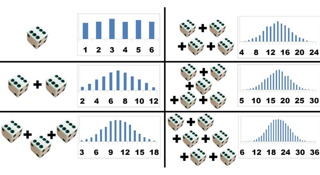

Another basic statistical concept that is important in SPC is the probability distribution. Random events can be characterized using probability distributions. The possible scores when you roll a six-sided die follow a simple probability distribution. The die has an equal chance of rolling a 1, 2, 3, 4, 5, or 6. If the die is rolled 6,000 times, you would expect each number to occur approximately 1,000 times. If you made a bar chart of the scores, the bars would all be of roughly equal height. This rectangular shape is known as a rectangular distribution. The uncertainty due to rounding a measurement result to the nearest increment on an instrument’s scale has this rectangular—or uniform—distribution, since there is an equal chance of the true value being anywhere between ± half an increment on either side.
When two dice are rolled, something interesting happens. The score can be any integer between 2 and 12, but you are much more likely to get a score of 7 than a 2 or a 12. This is because there are several ways to score a 7 but only one way to score a 2 or a 12. For example, to score a total of 2, both dice need to roll a 1. There are two ways to score 3 (A = 1 and B = 2) or (A = 2 and B = 1). All the possible scores, with the different ways to achieve them, are as follows:
Ways to score 2 : (1,1)
Ways to score 3 : (1,2)(2,1)
Ways to score 4 : (1,3)(2,2)(3,1)
Ways to score 5 : (1,4)(2,3)(3,2)(4,1)
Ways to score 6 : (1,5)(2,4)(3,3)(4,2)(5,1)
Ways to score 7 : (1,6)(2,5)(3,4)(4,3)(5,2)(6,1)
Ways to score 8 : (2,6)(3,5)(4,4)(5,3)(6,2)
Ways to score 9 : (3,6)(4,5)(5,4)(6,3)
Ways to score 10 : (4,6)(5,5)(6,4)
Ways to score 11 : (5,6)(6,5)
Ways to score 12 : (6,6)
The probability of each score increases linearly from the lowest value to the middle value and then decreases linearly to the largest value. This type of probability distribution is known as a triangular distribution. A triangular distribution occurs whenever two random effects with uniform distributions of similar magnitude are added together to give a combined affect.
When more random effects are combined, the peak of the triangle starts to flatten, and the ends extend into tails, giving a bell-shaped distribution known as the Gaussian, or normal, distribution. Lots of uniform or triangular distributions add up to give this normal distribution. In fact, the normal distribution occurs whenever lots of different random effects, with different-shaped distributions, add up to give a combined effect. This is proven more mathematically by the central limit theorem. Because of this effect, the normal distribution occurs very commonly in the complex systems of the natural world, and processes are often simply assumed to be normal.

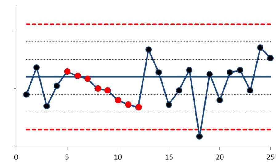

A run chart is a simple scatter plot with the sample number on the x-axis and the measured value on the y-axis. It presents a view of how the process changes over time.

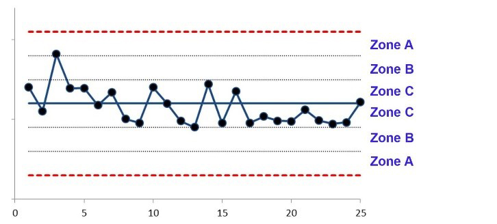

Control charts are very similar to run charts, but they also include control limits and often other zones. For example, there may be horizontal red lines at ±3 standard deviations representing the control limits, and additional horizontal lines marking ±1 and ±2 standard deviation. The number of standard deviations is often simply referred to as sigma. A control chart is a very important graphical tool used in SPC. It is used to monitor processes to check that they are “in control.” The regions between the process mean and the ±1 sigma may be referred to as Zone C, between 1 and 2 sigma as Zone B, and between 2 and 3 sigma as Zone A. It is important to understand that the control limits do not relate to the product specification or tolerance in any way. They simply show the variation of the process when it is under control, so that its current operation can be compared with that state. Process capability is also important and should have been established during phase one of the SPC, where the process is set up. The control chart is used during phase two to ensure that the process is stable.
A control chart makes it easy to spot when a process is drifting or producing errors that cannot be explained by normal, random variations. For example, if several points are all increasing or decreasing, then this would indicate the process is drifting out of control.
Different rules may be applied, but in general, if any of these conditions are true, then it indicates that the process is out of control:
• A point is outside control limits
• Seven consecutive points on same side of center line
• Seven consecutive intervals increasing or decreasing
• Two out of three consecutive points in same Zone A or beyond
• Four out of five consecutive points in same Zone B or beyond
• 14 consecutive points alternate up and down
• 14 consecutive points are in Zone C
