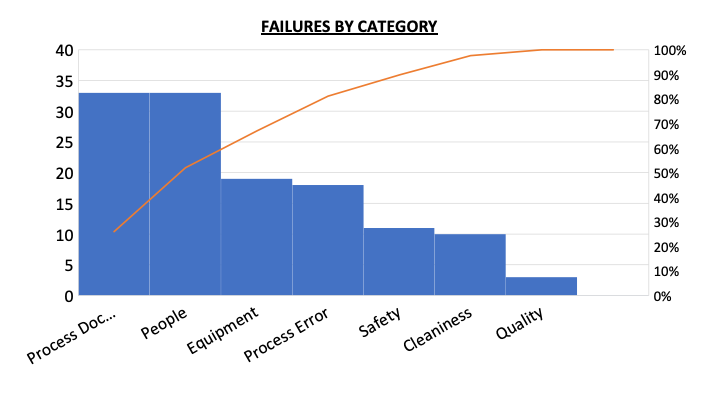

Slicing and dicing nonconformance data in different ways is a quick way to identify your biggest trouble areas on an organizational level. Many companies will track audit nonconformances according to categories such as:
• Process area
• Types of LPA questions failed
• Nonconformance type, e.g., tool calibration, process, documentation, or scrap
• Most common corrective actions
• Quality vs. health and safety findings
Viewing these data in Pareto chart format can help you pinpoint where your efforts will have the biggest impact in the organization. Let’s say you have an ambitious goal of reducing failures 25 percent. Using the second y-axis that correlates to cumulative percent, you can easily pick out a few categories to focus on that will get you to your goal.

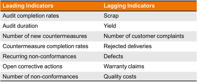

Many organizations are interested in using predictive analytics to improve quality performance. One way they can do that is to look at how metrics like audit completion rate, audit pass rate, and nonconformance rate change over time. By applying time-series analysis to these data, companies can identify trends and potentially even predict what that rate will look like three months into the future.
This analysis is particularly powerful when applied to leading metrics that correlate with other key quality outcomes. For instance, if an uptick in audit nonconformance findings usually precedes customer complaints, you can step in before that happens if you notice nonconformances increasing in any given plant.
Taking it a step further, manufacturers could then use this information to develop poka-yoke tools targeted to specific high-risk processes or steps. At the end of the day, this kind of concrete action is what tracking LPA metrics is all about: using completion rates, pass rates, and nonconformance data to drive targeted quality improvements.
