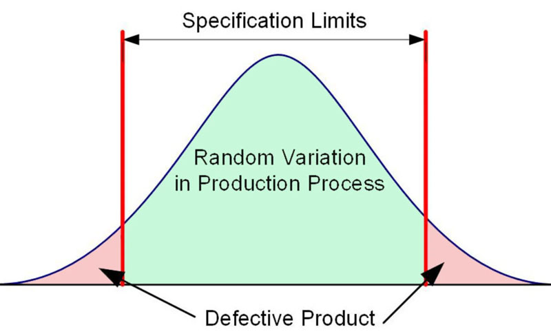

When the random variation in the production process is greater than the product’s specification limits, a defective product will be produced; the process is not capable.

It is clear that Cp is simply the ratio of the total tolerance to six standard deviations in the process. A Cp of one therefore means that plus-or-minus three standard deviations of the process would fit within the tolerance limits, assuming the process is centered about the nominal value. A Cp of one is typically regarded as a bare minimum value for capability. A Cp of two means that plus-or-minus six standard deviations of the process would fit within the tolerance limits. This is often the ultimate goal in quality engineering and is where the name for the Six Sigma methodology comes from.
Cp ignores bias. This means that a process could have very little variation but consistently produce parts that are either too big or too small.
