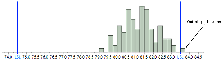

Figure 1 plots the 108 thickness measurements in a histogram against the specifications. The problematic point, located above the upper specification limit, was sample 100 from production run 9.
Figure 1: Histogram of part thickness data during nine production runs. The blue lines, LSL and USL, are the lower and upper specification limits.

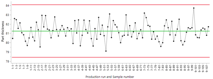

A control chart of individual values, or process behavior chart, of the data is shown in figure 2.
Figure 2: Control chart of individual values for the thickness data
Interpretation of figure 2’s control chart allows us to characterize the process as stable. This means there are no unnatural patterns in the data that would signal the occurrence of process changes, i.e., instability. (Postscript 1 below gives an overview of how to interpret a control chart.)
The two red lines at 78.4 and 84.1 in figure 2 are natural process limits, or control limits, which define the “voice of the process.” This voice tells us to expect process outcomes between 78.4 and 84.1:

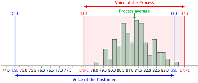

Out of specification is also synonymous with trouble. To plan how to get out of trouble, we start by comparing the voice of the process with the voice of the customer, i.e., the specifications (see figure 3).
Figure 3: Representation of the voice of the process and the voice of the customer. (LNPL and UNPL are the lower and upper natural process limits.)
With an upper specification limit of 83.5, and with process outcomes as high as 84.1 expected to occur in routine production, figure 3 shows graphically that the current process is not capable of meeting specifications.
Figure 3 also provides the insight to define the options to make the process capable:
Option 1: Lower the process average to ensure the control chart’s upper natural process limit is below the upper specification of 83.5.
Option 2: Reduce the level of variation in the process by changing the process in some fundamental way (e.g., use new materials, operating procedures, or equipment, or measure samples in duplicate or triplicate rather than just once).
Option 3: Do both, i.e., a more optimal average and a reduced level of process variation. (See Postscript 2 for a discussion on both these improvement strategies.)

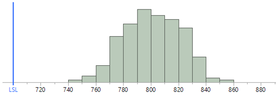

A histogram of the 200 measurements in relation to the lower specification is shown in figure 4. (There is no upper specification.) The histogram suggests all is OK because the measurements are located at a safe-looking distance above the lower specification.
Figure 4: Histogram of the time to process data, including the lower specification limit of 700 seconds

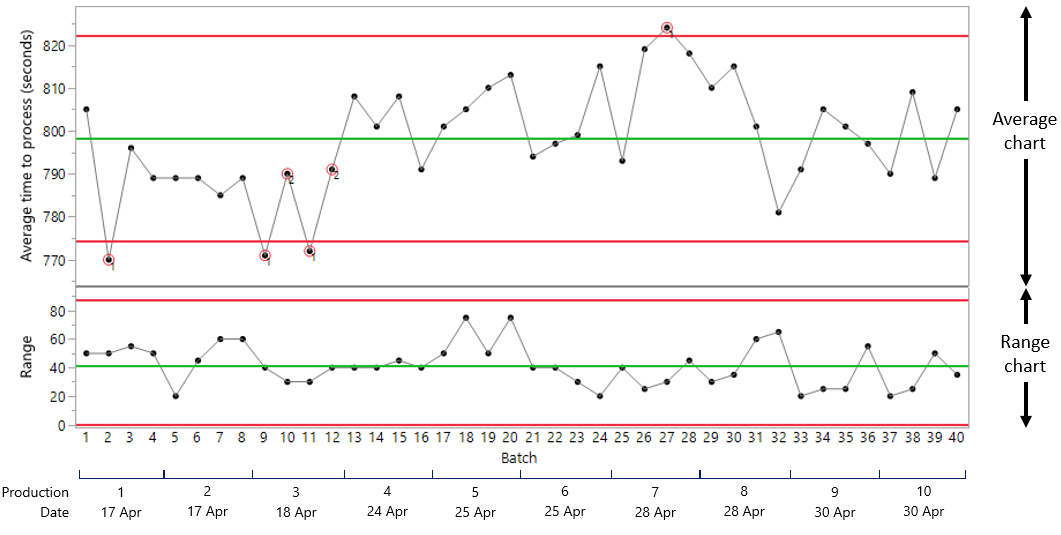

Is all OK, meaning no need to ask further questions? To answer this question, we start with an average and range control chart (see figure 5.). Each point on the x-axis uses data from one batch. Five measurements are routinely taken across each batch, and the variation within batches is judged appropriate to study the variation between batches.
Figure 5: Average and range chart for the time to process part 76
With several signals of process change in figure 5, this process must be characterized as unstable over time. (Again, refer to Postscript 1 for some guidance on control chart interpretation.)

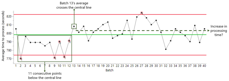

We start by making sense of the signals of instability in figure 5: When are the changes in the process—the instability—thought to have occurred?
Batches 2 to 12 on figure 5’s average (upper) chart are all below the central line (which is the average of all 200 data). Batch 13’s average jumps up above the central line, and for the rest of the record, the average time to process part 76 looks to have increased. This interpretation is illustrated in figure 6 and tested in figure 7’s average and range chart, with the process limits based on the data from batches 1 to 12 only.
Figure 6: Figure 5’s average chart with annotations

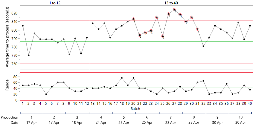

Figure 7: Average and range chart of the time to process part 76, with the process limits based on data from batches 1 to 12 only
Figure 7 supports the theory that a reasonable degree of stability was present during the production of batches 1 to 12 because there are no signals in the data. Stronger still, the postulated increase in processing time from batch 13 onward is absolutely clear because 27 of the last 28 points are above the central line on figure 7’s average chart.
This understanding tells us to ask what happened around the time batches 12 and 13 were produced. The team investigated:
• Friday, April 18: Last production of the week
• Monday, April 21 to Wednesday, April 23: Periodic maintenance of the line
• Thursday, April 24: Restart production
The investigation identified an error from the periodic maintenance. A bias error in a temperature-sensor loop calibration meant the actual temperature in a heating step was several degrees below the target temperature because of the error in the sensor measurement. This error explained the sustained increase in processing time between April 24–April 30. The loop was recalibrated and the error eliminated.

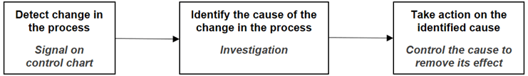

Using the control chart, the steps involved are shown in figure 8.
Figure 8: Detecting and responding to instability in a process
Success with figure 8 leads to an improved process with leverage for optimization. As discussed below, this leverage can be translated into cost savings.

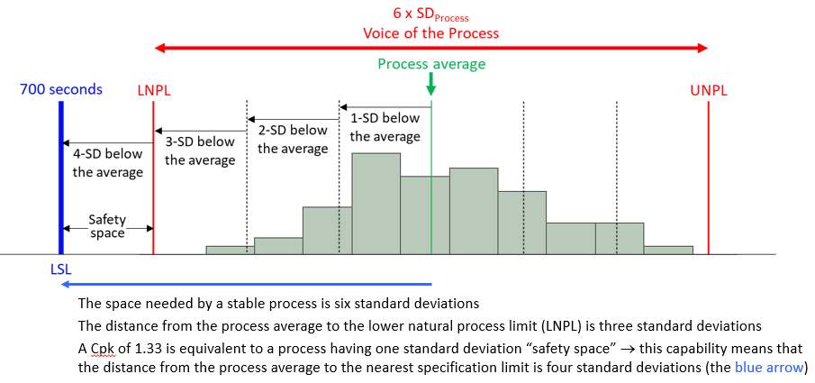

Next, the plant manager would accept a process capability Cpk of 1.33 in the optimization of this operation. For a stable process, this level of capability provides one unit of standard deviation of “safety space” vs. the nearest specification limit, as shown in figure 9.
Figure 9: Visual representation of Cpk = 1.33 with only a lower specification limit in place; the histogram is the data from batches 1 to 12.
As per figure 9, the optimal process average is estimated as follows:

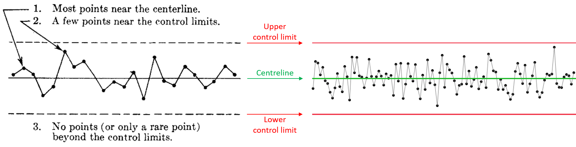

Interpreting a control chart starts with the characterization of process behavior: stable or unstable? In traditional control chart terminology, this refers to the process being in- or out of control, meaning statistical control.
As per the Statistical Quality Control Handbook by the Western Electric Co. (second edition, 1958), a stable process possesses the following three characteristics (defined as a natural pattern on page 24):
• Most of the points are near the solid centerline
• A few of the points spread out and approach the control limits
• None of the points (or at least only a very rare and occasional point) exceeds the control limits
These three characteristics are shown visually in figure 32 of the SQC Handbook (reproduced below as figure 11).
Figure 11: The three characteristics of a natural pattern—a stable process—as per Western Electric

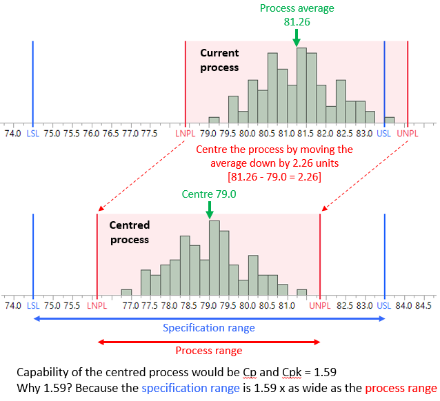

Situation 1: Process target is the center of the specifications
As discussed above, the part thickness process was not capable because process outcomes higher than the upper specification limit were expected. This was illustrated in figure 3 and is shown in the upper histogram in figure 12.
The center of the specifications is 79.
Calculation: .
To hit the target of 79.0, the process average must be reduced by 2.26 units (81.26 – 79.0 = 2.26).
Operating the process in the center of specifications would deliver a capable process, as illustrated in figure 12 .
Figure 12: How to center the process in the middle of the specifications and deliver a capable process

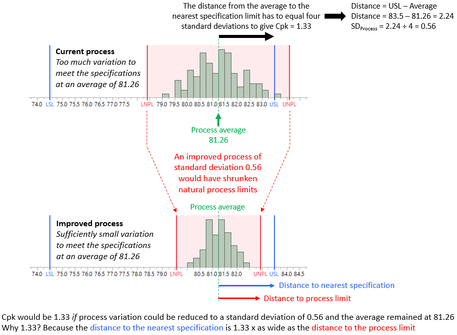

Situation 2: Process target is the current average
The only way to achieve a capable process at the current average of 81.26 is to reduce process variation. As shown in figure 9, for a Cpk of 1.33, the distance from the process average to the nearest specification is four standard deviations. An improved process of Cpk 1.33 at the current average is illustrated in figure 13.
Figure 13: Illustration of the improvement needed to reduce variation at the current average and achieve a Cpk of 1.33
The formula for Cpk is:
Because the process has been operating closer to the upper specification limit, the formula becomes:
In relation to the upper specification limit, a Cpk of 1.33 is as shown in figure 13’s lower histogram. The improvement envisaged in figure 13 would not be trivial. It would require a near twofold decrease in the process’s standard deviation, from 0.94 to 0.56. As a general rule, it is often easier, even much easier, to relocate the process average than to reduce process standard deviation.
