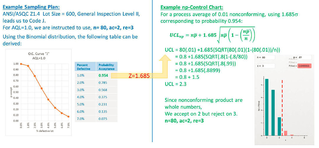

To further illustrate the property of process control, the example of figure 2 is chosen from MIL-STD-105 for a lot size of 600 units under General Inspection Level II, Single Sampling, Normal Inspection, AQL = 1.0. This corresponds to Code Letter J, and sample size n=80. The decision criterion for process acceptance are accept on Ac=2 and reject on Re=3. The operating characteristic curve can easily be calculated using the binomial distribution (figure 2 left). Readers should take special note that when the lot presented for inspection is the same quality level as the process average (p=0.01), the probability of acceptance is 0.954 (0.046 producer risk). This decision criterion is clearly not set at 3σ (0.997) as would be standard control charting convention. In fact, using the standard normal distribution of Z values corresponding to 0.954, we see that the “decision limit” is set at 1.685σ.
Validating the Ac and Re numbers can be done in similar fashion to the ‘np’ control limit calculation appearing in figure 2 (right). Substituting 1.685σ instead of the conventional 3σ used for “control limits” yields a “decision limit” of 2.3. Therefore, when using “decision limits” on an ‘np’ chart for a process whose process average is 1 percent nonconforming, and the sample subgroup size of 80 units, we should accept the lot on two and reject on three nonconforming units.
Dodge would actually fix the AQL point as the process average, calculate the 3σ limit using the AQL value as if it were the process average, and switch to tightened inspection if the cumulative average of the past 20 lots exceeded this limit.5 Dodge further makes note that control charts were a part of standard procedure for the lot-by-lot sampling results for thousands of inspection layouts used in the shop process and final inspection.2 We can actually plot on an np chart, with two sets of limits: decision limits for lot rejection and corrective action; and control limits for determining when to additionally switch to “tightened inspection.” The examples here serve to illustrate the link between “process control” and MIL-STD-105.
![]() Figure 2: Single sampling plan n=80, Ac=2, Re=3 (left); and corresponding ‘np’ chart upper control limit (right) |
