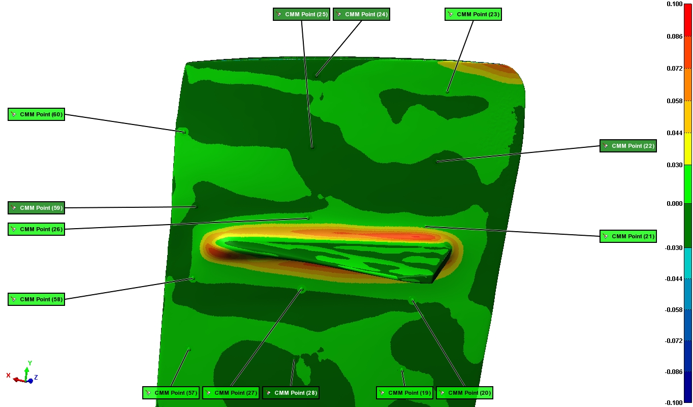

![]() Typical CMM probes a part’s external dimensions at a limited number of touch points. Click image for larger view. |

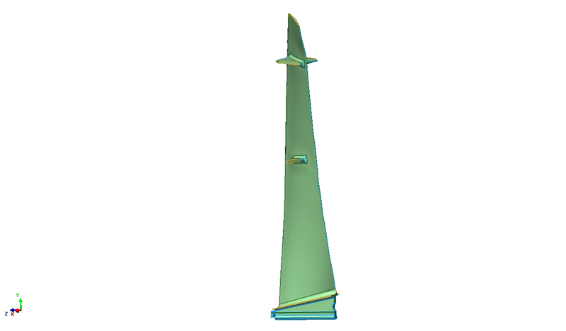

![]() 3D laser scan can capture millions of points instantly comparing them to a CAD file or cloud-resident data. Click image for larger view. |
In contrast to conventional, tactile CMM techniques, laser and especially CT scanning captures all surface points simultaneously, on even the most complex, convoluted surface areas. As an example, where a typical touch probe might capture 300 points of reference for comparison to a CAD overlay, the laser or CT will capture millions of points. Typical systems today can offer measurement accuracies to 4+L/100µm, referring to the VDI 2630 metrology guideline.

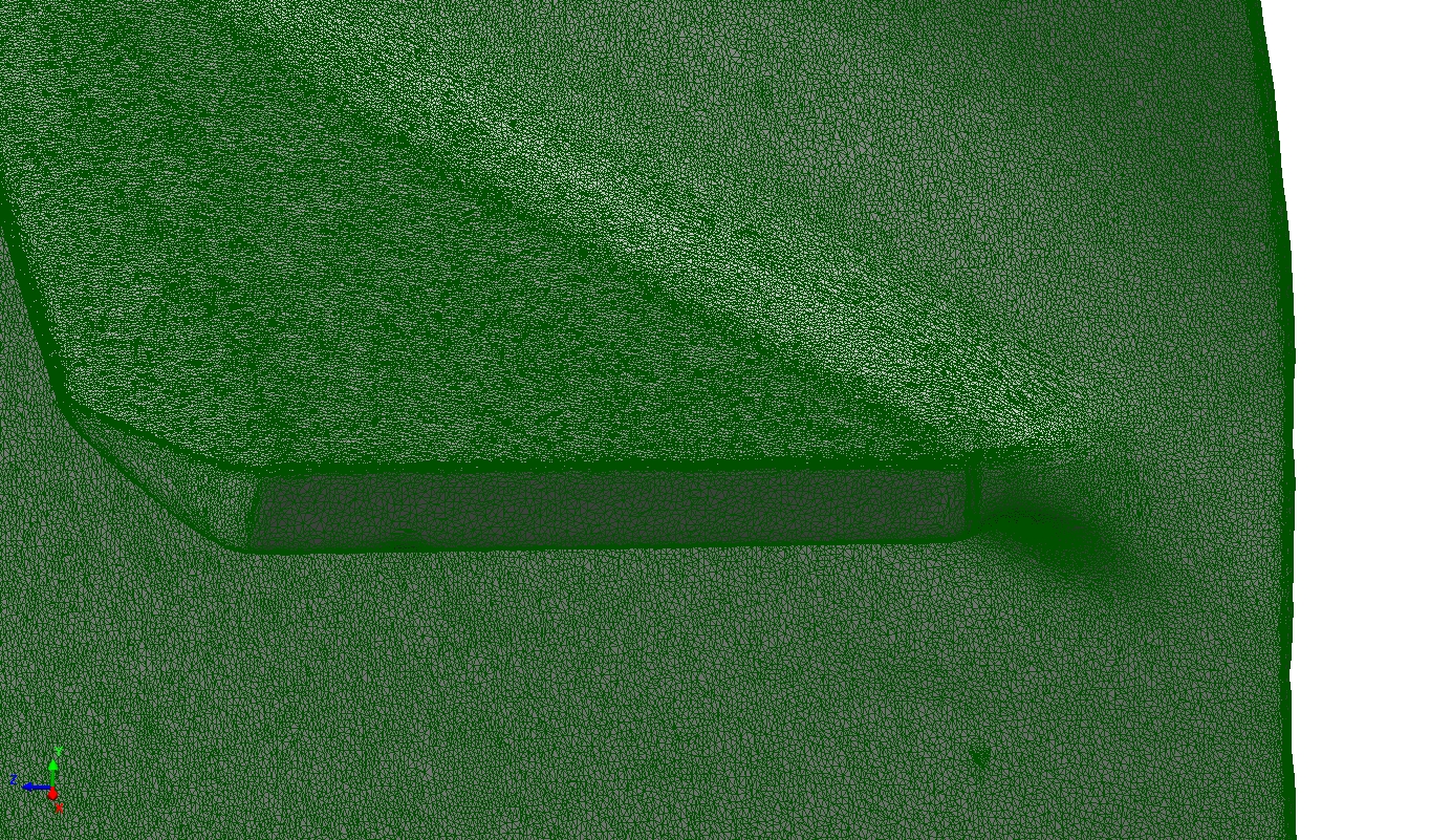

![]() 3D printing allows quick sampling of modified designs as well as finished prototypes, producing parts directly from the scanned data. Click image for larger view. |
